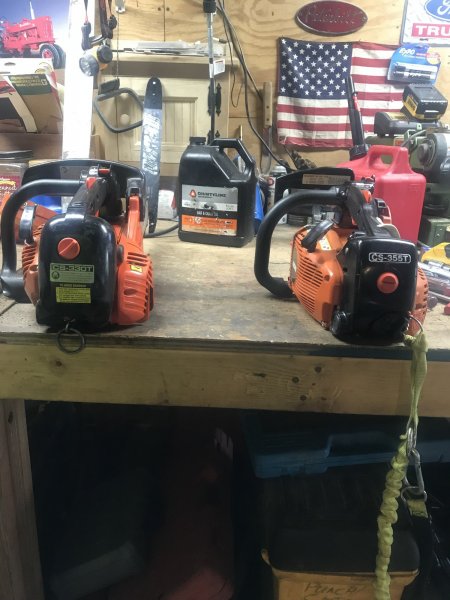

    I’d like to get a hold of an older gray saw someday. The one on the left in my last post is a 7 year old 330t and the one on the right is a year old 355t. So I guess the “box” saws are done, unless they do a retro throwback:p

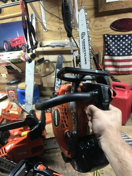

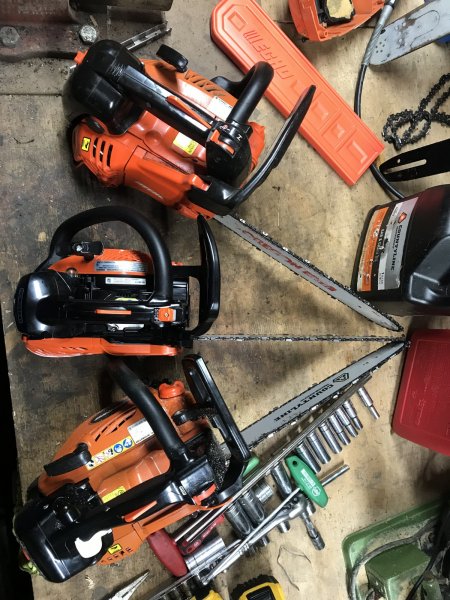

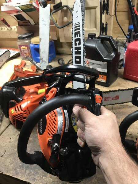

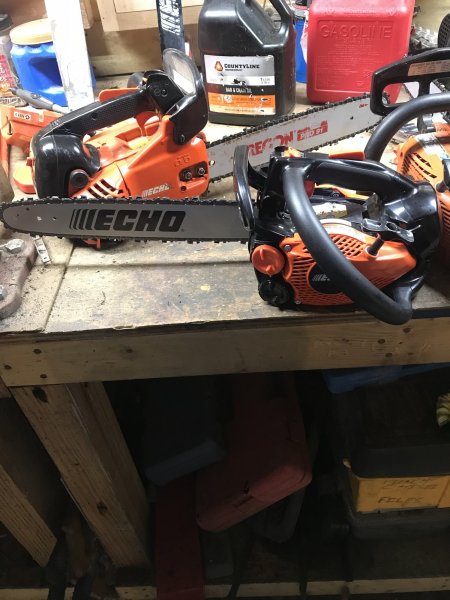

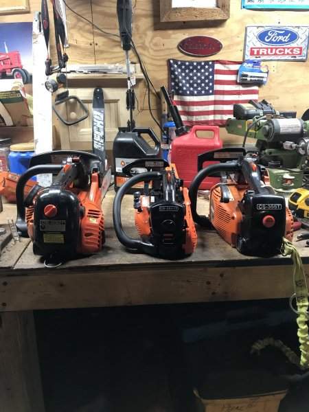

    I’m not really sure how to explain the “tiny ness” of this saw but it seems to be an angry little feller! Here’s a couple size comparison pics, they still don’t do it justice until you put it in your hand. I got a 14” bar set up with 3/8 lp.050 for a bit of extra reach and so it matches my my 330 hardware. C25C3425-08BE-42DE-BCC7-32F4B8BE9349.jpeg 2511 4B8F3BAE-3652-472E-9E20-E9143D041E62.jpeg 355 0C120245-D346-4B72-8F4D-DBEE7CC73B45.jpeg top to bottom 330,2511,355 B7FA4716-83A7-4E16-92FE-6AF83C4F14E3.jpeg I already want to do the muffler :dremel: I can tell it’s packing a cat much like my older 330. My dealer yanked the limiters for me already too without even asking we even tach tuned it out of the box in and told me bring it back after a couple gallons and we can see what she’s really made of. We also made some full bar cuts in a silver maple log he had and I’m impressed!

    :dex: best comparison I can make for people is to pick up one of them kids saws at the toy store then imagine it's a real saw. Let us know what you think of it when you get a chance to put some time on it.

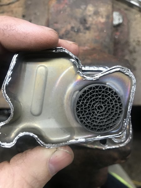

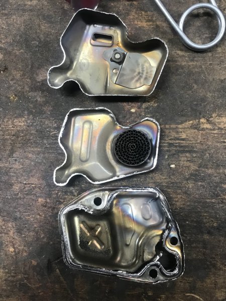

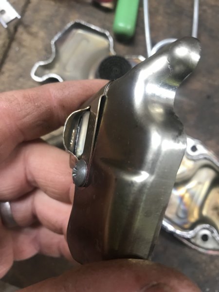

    Well it was a windy day yesterday and didn’t get a chance to run the saw. I worked on a couple other saws to clear the bench and call me crazy, but I couldn’t resist! :picard::dremel:

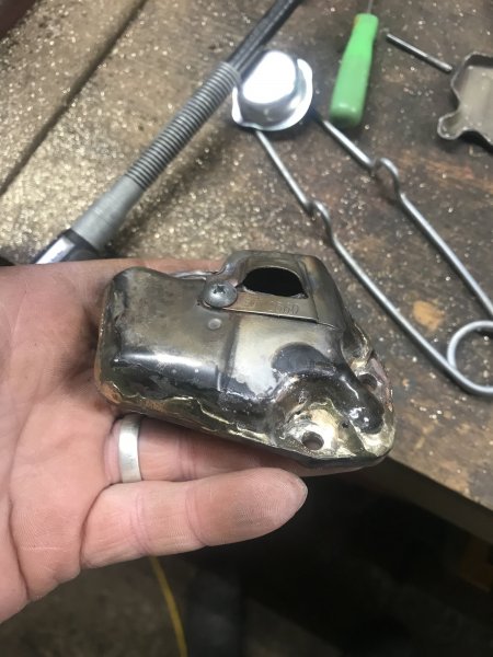

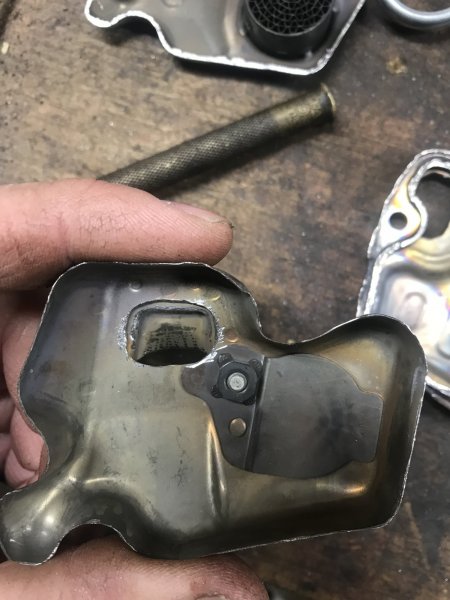

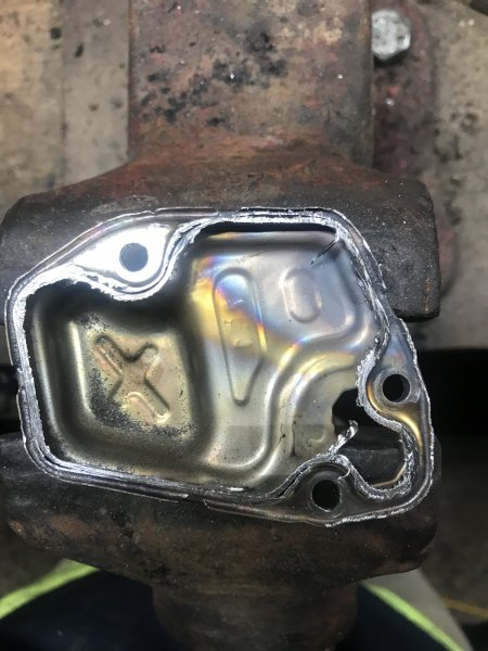

    First I looked at the joint and thought it was brazed in so I tried some heat and came to the conclusion that wouldn’t work since they must resistance weld the halves. Out came the old portable bandsaw!
    Cylinder side internal view CD0BF562-7AF7-40D5-9967-79BFD65DF454.jpeg outer view of outlet half 72133B31-AEF1-4A61-93BE-49ED4D7E4C9C.jpeg internal baffle and cat. Makes it a three piece deal. 67280855-4FC9-40D0-8386-6A9B2CF08775.jpeg internal view of all three pieces. F02BD4C6-3286-46CE-8D7B-1B397C163BE6.jpeg As factory exhaust enters through the port of the bottom piece in the pic and has to travel between the inner baffle and the cylinder side muffler wall. Then it’s got to go through the dreaded honeycomb and straight into that tab/heat shield on the first piece in the pic. It has hardly a 1/16” between that tab and the cat to make its exit into the area between the outlet side of the muffler and the center baffle. Then of course the tiny outlet.

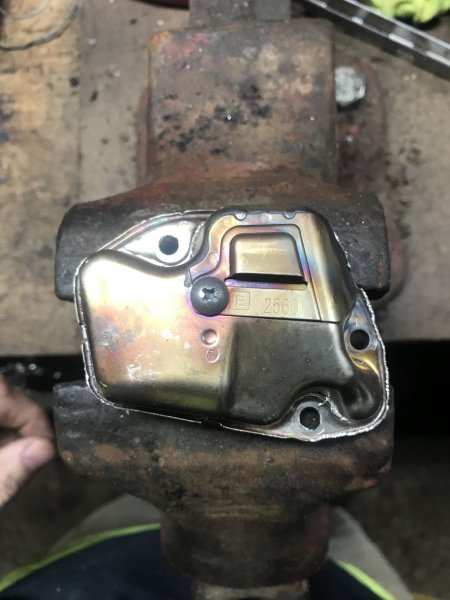

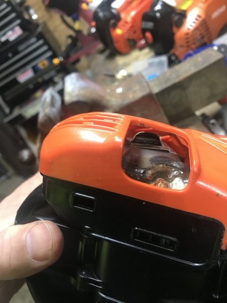

    Proceeded to buzz the factory hole open. I kept it under the factory deflector, but opened it to almost the same size as the inlet. BD0B3233-3638-46BF-A703-494311E91454.jpeg massaged out the factory deflector 70AA406D-50DE-4A7E-8AD8-EF8B177D5052.jpeg Brazed it back together. I had a heck of a time with the braze job! The outer shell metal is super thin and where the original crimp/weld is was pretty thick and hard. I couldn’t get the heats right or the braze to flow so it’s messy and there was a bunch of grinding as you can see the pile of brass chips on the bench. 12F917C6-9905-4408-8BB2-46857C42E5A6.jpeg Cleaned and Back home. 519AEEDB-8A50-4FCE-AFC5-EEB9695AED01.jpeg
