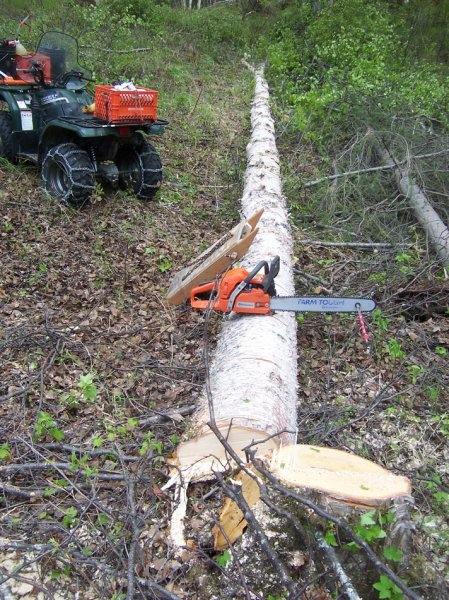

  2. bogydave
    I take the time to limb & clear the trip hazards on one side .
    Square up the butt end.
    Then put the rod on & walk the log marking as I go.
    Remove & cut the logs to skidable size, skid to the truck, buck & load.
    That way, I have all full length rounds, no short ones.
    1st Pic from a couple years ago ( birch) :

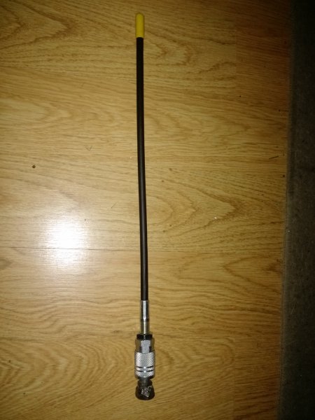

  8. Horkn
    29,160
    166,375
    I'll try it out on Sunday.

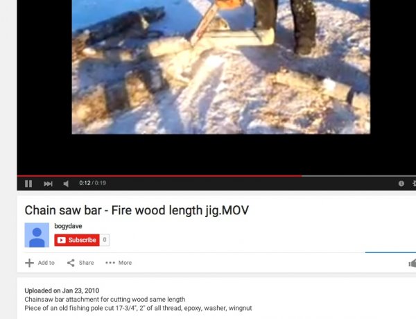

  9. bogydave
    No, never saw that vid, thinking they copied me. Mine I posted on u-tube, Jan 2010
    HDRock gave me the idea of the earth magnet
    Original was 1/4" bolt with a wing-nut
    Posted the utube a video in 2010 on another site
    This page links to the original post: They have the original post "locked"
    this site won't allow links to herth.com
    http://www.hearth.com/talk/threads/log-length-guide.88401/#post-1147065
    Date uploaded to u-tube bottom left of pic:

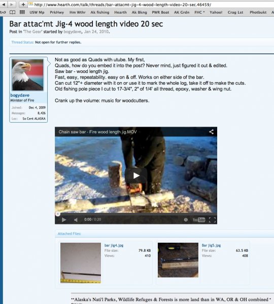

  11. bogydave
    Probably in trouble for positing a grab picture of the original hearth.com thread, 24 Jan 2010
    Am I the chicken or the egg ??? LOL
    edit LOL!.jpg :::::
    :rofl: :lol: Can't even type the word H e a r t h :rofl: :lol:
    you guys need to let it go, (visit " mov-on .org )
    Can I say, "are you still measuring your dicks ?? " :rofl: :lol:
