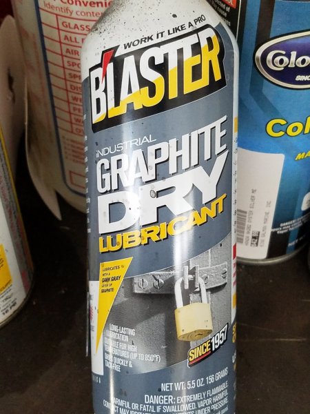

    I have used a graphite spray successfully on the handle to our stove door. It has a light solvent to act as a vehicle to the graphite to penetrate and carry it into the crooks and nannys. Comes with a red tube to concentrate the spray. My only complaint with it is that you have to spray and let dry several times to deliver a sufficient amount of graphite to the hidden workings and inner mechanisms. As with any lube you have to redo it occasionally. graphitespray.jpg

    I had purchased a can of this, just for this problem, but I didn't seem to have any luck with it.
