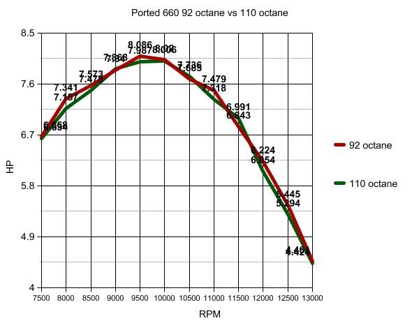

    Burnt five gallons of 92 e free mix since may on dyno runs.

    About how many saws have you tested?

    If I counted right around eighteen. I've run half of that fuel through a brand new 660 I'm doing part testing on.

    I'd like to do some fuel useage tests soon. Do you guys think a chainsaw carb would have enough suction to pull fuel through an extended hose that goes out the fuel cap hole and into a measuring container?

    Just put the container above the saw.

    If you have a look at: http://www.scientificsonline.com/ under lab equipment, you will find what you need. A hanging beaker with hose attached already graduated in ml. This way you can hang it above the saw and connect the carb directly to it, take a reading before run and after.

    You can get away cheaper by using a graduated 2-stroke 1qt oil bottle and cap and a brass hose barb from the hardware store.

    I'm curious to see the octane tests (110 vs 92). That 110 smells good burning and has a purple tint color. "Purple haze vs Pump gas"!

    Kinda boring. I was expecting different.

    What was you expecting?

    Mixed. My hunch was saying the 110 would have done worse but Ronn thought it did better.

    Do you think there might be bigger difference on a stock 660?
