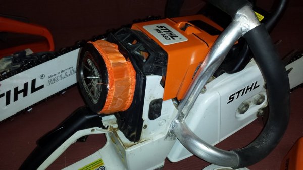

    Tested again with a 460 coil on it. Raised the hp a little bit but still has that funny dip. Who cares its got power where it counts.[​IMG]

    Wow! Is there anything special about that coil or just a standard coil?

    Standard 460 coil. I wander how this would test without an air filter? Could it be an air issue?

    Chad I do have the Stihl prefilter on there. Take it off if u wanna

    My understanding is that the HD2 filters are supposed be run sans pre-filter.

    Cant help but think the pre filter would impede flow

    That's a pretty heavy pre-filter, on an already good air filter. I don't know if that's the problem, but it sure ain't helping.
    Ever looked into Outerwears? They are a cheap solution, to running the heavy, thick, and restrictive OEM covers for the standard HD set up.

    Yeah....I already removed it for the test. I'm curious as to why the saw dips there but If you want your saw back I'll get it shipped back. In was just thinking about what a member messaged me about. He said that he's seen dips like that from air filters. Somewhere the flow of air might hit some disturbed flow. I could put a max flow filter on it or a rag to just keep something from falling in. It's a clean atmosphere where I'm testing.

    Throw a max flow on it and test again please. That's what I run on mine 90% of the time.
