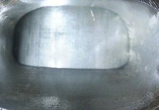

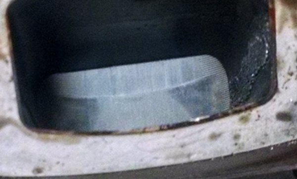

    Yeah I did that for KG461 and posted it on anothersite. It was pretty conclusive to me. I'll finish up the 110 and not spend double on it any more. It does smell good though.
    550 piston with motul 800 and 93 octane.
    7900 with K2 and 110 octane
    Moparmyway, Chvymn99 and MasterMech like this.
