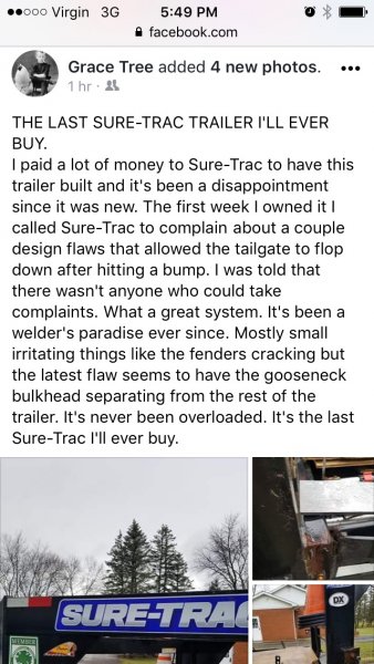

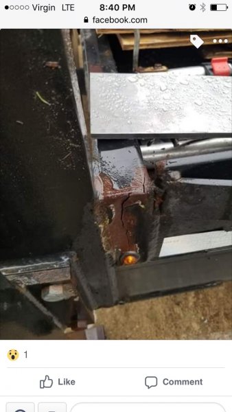

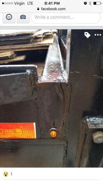

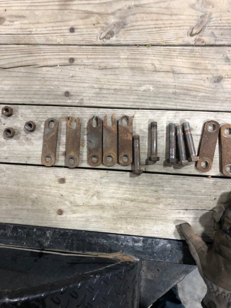

    While I'm glad to see you're happy with your suretrac, they are junk IMO. A guy I know had them build a custom made gooseneck for him and it's cracked where the bulkhead and deck meet. Suretrac told him to pound sand. Also, they have problems with the shackles. 2 year old trailer.

    That looks like a lightduty gooseneck, like a 10k gross. I have a feeling you are not getting the full story about your buddies trailer. Judging by the pictures it looks like it has been overload and/ or driven over rough terrain fast. It would have been nice to have seen a full pic of the trailer to see what the rest of it looks like currently. One thing that is really suspicious, is the torn shackles. Shackles are somewhat universal on trailers. This set does a 4k to 14k trailer. Greaseable Tandem Axle Trailer Spring Suspension Rebuild Kit Wet Bolt 3" Shackle | eBay Then with the gooseneck separating, that is another indication of abuse. It is not like the welds broke, the metal is breaking. What did the dealer where he bought it say?

    You're making a lot of assumptions....the trailer was custom built for his tracked lift. He wanted a low profile gooseneck and they made this for him with his needs/requirements in mind. The problem is the bulkhead has no angled bracing. The trailer has only ever hauled the lift in the pictures and he doesn't drive the truck & trailer off road. The lift weighs ~7700 pounds, so it's under a 10k limit regardless. The owner is a retired semi truck driver, so he knows a thing or two about driving and loading trailers too. The dealer referred him to the manufacturer since it was a custom build.
    As for the shackles, that's a different owner and trailer, but he also said to steer away from sure-trac. I do have a third friend with a sure-trac dump trailer and I've used it before, seemed to do the job just fine.
