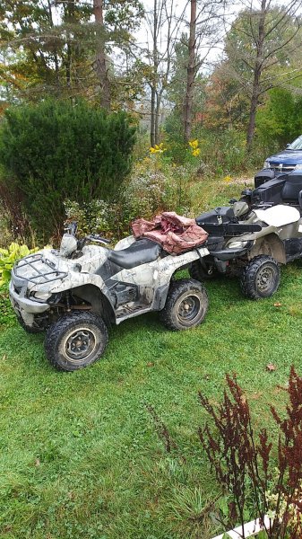

    Oh, as an aside, my ducks went "out of row"
    :rofl: :lol::rofl: :lol:
    Purchased this on Friday..
    :whistle:
    '09 Kingquad 500
    This explains why the savings acct is in Chazsbetterhalf capable hands.
