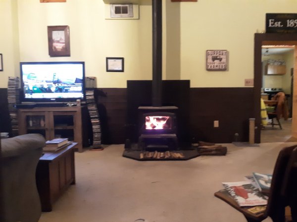

    As a card carrying member of the "safety police" (our neighbor's house just burned, a total loss, kitchen area): "code" requires no flammable material within four feet of a wood burning appliance because opening the door can emit embers. I like dry wood but... all my indoor wood, kindling, and paper is four feet away.

    Iowahiker has it nailed (from iowa myself), you use the same clearance distances as your stove information states, the wood will dry quickly and you are being smart about it.

    I'm of the opinion that one can dry wood near the wood stove, but only when it is closely monitored. Check the wood with a temperature gun and don't leave it close when outside, sleeping or away from home. I have some small stuff drying near the Buck-81 in paper shopping bags. The hottest temp I can find right now is 130 degrees F. That is with the stove blower on. I know that if the blower unexpectedly goes off, the temperature rise from radiant heat will happen rapidly and I will need to react quickly. IMHO if you are using your stove to dry wood and not actively monitoring it, you're literally playing with fire.

    Best advice yet! By all means, dry your wood next to the stove but observe the manufacturers stated clearances.

    I stack wood on either side of the stove but the stove has side heat shields. The shields don't come all the way to the front of the stove so I am careful about stacking where there are no shields. The hottest part is in front of the stove where the glass door is located. Infrared energy is transmitted through the glass so that is the hottest area we need to be concern about.

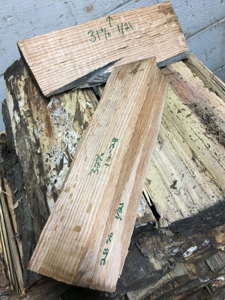

    So a while ago I mounded up, about 4-5 feet from my stove, a stack of chunks and uglies that were laying on the ground @ my processing area. Some of these were from a huge oak I scrounged. Knowing how slow (red) oak seasons, I saved them for burning last. After they acclimated, I split one and measured it’s moisture. Just the other day, I split it again for a reading.
    It appears this chunk lost about 4% in a month. I’ve been pointing a fan at the pile, blowing hot air around it as much as I can.
