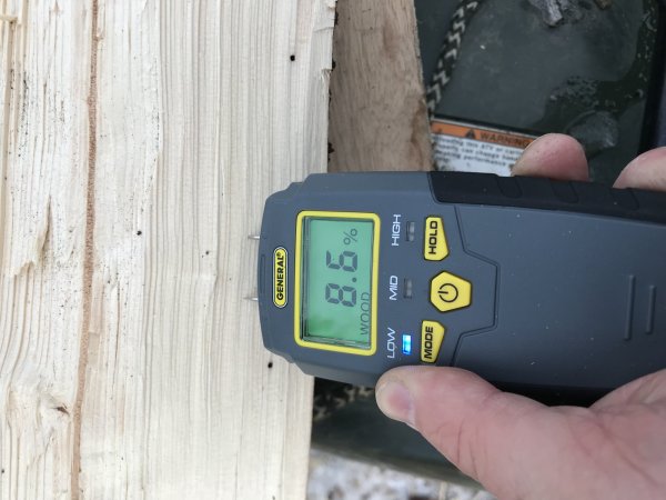

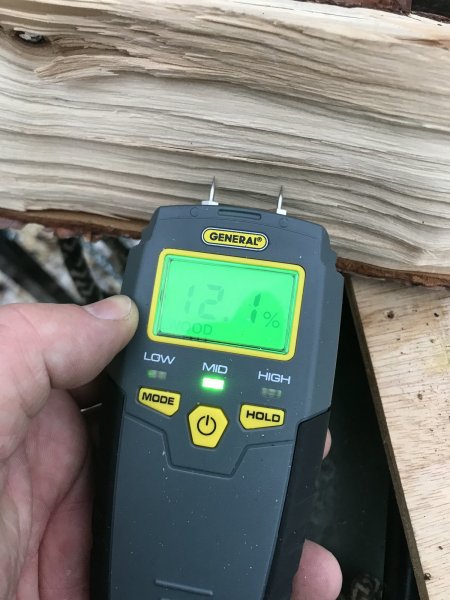

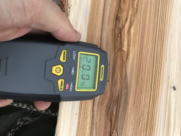

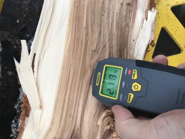

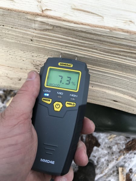

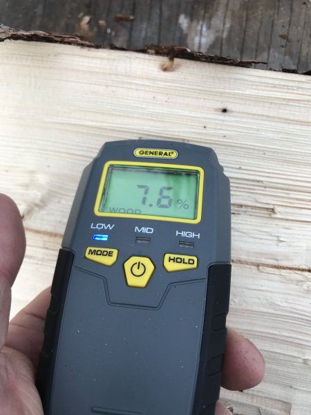

    Moisture meter came in, spruce the spruce was cut the same week as the birch. The one birch that is 12%was split last week, I broke the rules by not splitting again, I was courious to see how much the outside dried. It will be interesting to see what the moisture is as summer progresses. A425FD5C-A304-49FA-96AB-6C8C17C87D66.jpeg EFB71DDB-E865-4CBC-BD5F-3009AD0FF49F.jpeg 9B64FBD2-ADE1-4F21-BB48-F70BA4CBB721.jpeg 02F39165-BC9A-4C20-9A0E-B996C81F0494.jpeg 4A0C0554-D0F9-4586-AFFC-873BCBA8A64F.jpeg 7900B5DB-81BF-4D55-BB06-FDD7BF5BD7B3.jpeg 5972A8D0-EF95-4FA4-BB5F-ECDE480FD029.jpeg FB62ACBB-ABE0-4ABB-8AAB-1B165B78043C.jpeg

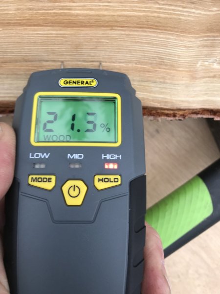

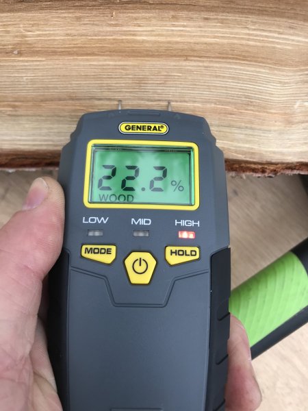

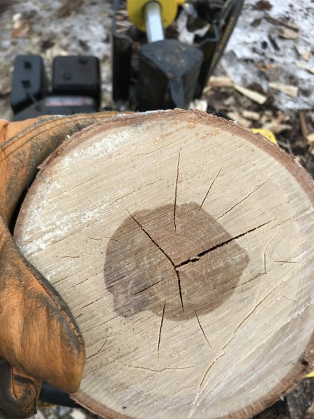

    A few more fresh split pieces from today, split around a 1/2 cord. A8594104-A92B-483A-90C9-31067D42C106.jpeg 0C7A4740-C7A6-4863-9F6D-33F446B8EB80.jpeg CF367F69-E160-4E8E-A048-F9202DEDD576.jpeg 436A0515-2211-45BF-93A3-6EFB6FE16E17.jpeg

    Tom I believe the wood has to also be a certain temperature to get the correct reading. But what do I know? Only for reading as I've never owned a MM nor do I have the desire or need to have one.

    Mr. Dennis you have forgot more than I know. Makes sense about a temperature use range. I mostly use how quick the wood catches as if it’s ready to burn.

    Savage speaks true - the meter is calibrated at "room temp" or about 68* IIRC. I found that mine (same exact meter) runs about 2-3% high if the wood is in the 20-30* neighborhood. Sorry for the estimates, but I tested in December. :) Also you may find a higher reading if you really jam the pins in there. Carefully.
    I'm sure there's a conversion chart out there.
    -edit- here's one. Third chart. Variances seem high to me, but maybe not?

    Yep, if it's flaming on hot coals in 30 seconds or less it's dry. If the meter reads higher at a lower temp that wood may be in the 15% range. I wonder if it'll gain a little moisture during the summer due to higher humidity?

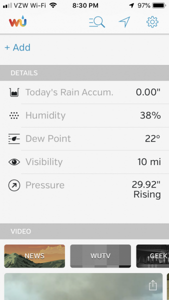

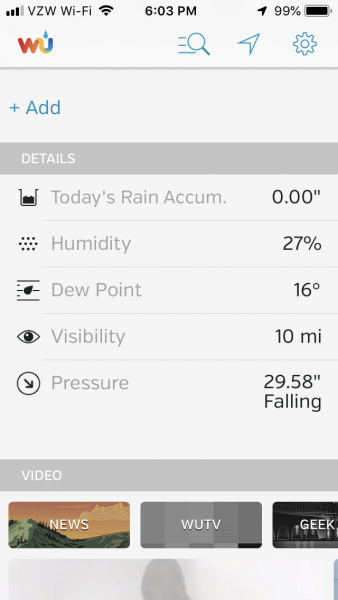

    Here is the last two days of humidity, should be helping to dry the birch. BFFFDA25-0468-42D9-9083-778C8A98FC66.png 1F03FC15-FF98-4F72-858F-710F7B659E61.png

    I like how that model has the word 'wood' instead a horribly tiny, hard to discern graphical icon.

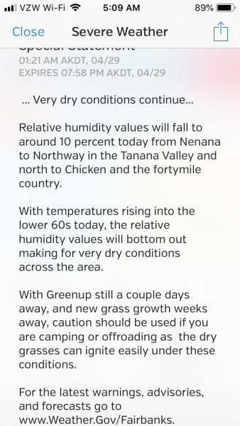

    Today we are in a weather warning for 10% real relative humidity, birch may loose some moisture. 1002B189-49DC-4526-90BF-1FDD788B80BE.png
