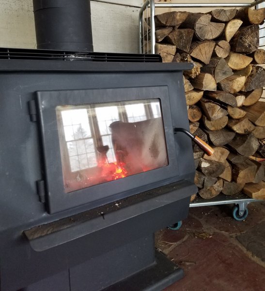

    I'm a firm believer in that even if it is dry. I'd like to get my hands on a few more of these carts.

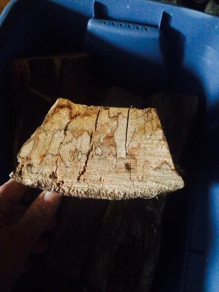

    I'll bet those 4 smaller ash on the left side of that photo might surprise you . This pic is 3 year old maple CSS in September. Been in a tote near the stove for week or 2 .

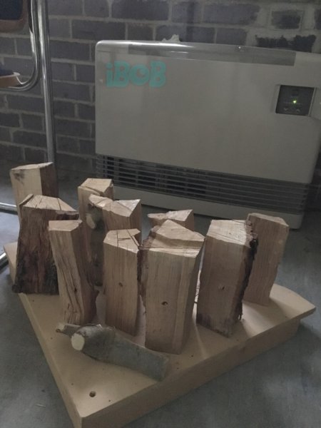

    Finally picked up a moisture meter and lopped one of those ash up. Measuring fresh splits from each round through the 9' log, if there was drying out the ends it wasnt obvious. All of them read between 22 and 26% depending on where in the split you measured and the end rounds were no different. For reference, the elm that is burning oh so sweet in the stove right now measured 13%. I'm going to leave my test splits near the stove and see what they do over the next week or so but this all looks like next year wood for my stove.

    I was kind of surprised how much my test splits dried even in just a day by the stove. So the Fiskars and I had our way with some more of the smaller Ash logs this morning....thinking I might use that handy dandy cart of mine to turn my blaze king into a blaze kiln while i am running harder during the cold weather. The vast majority of the heat from my stove comes off the front so a few spins of the cart over a few days may have a dramatic effect and that cart holds a quarter of a face cord. a firewood hoarders tanning booth if you will.
