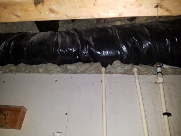

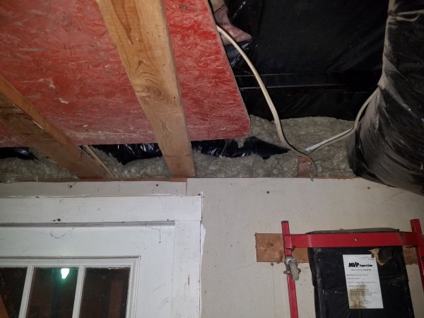

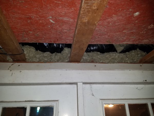

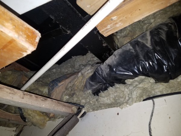

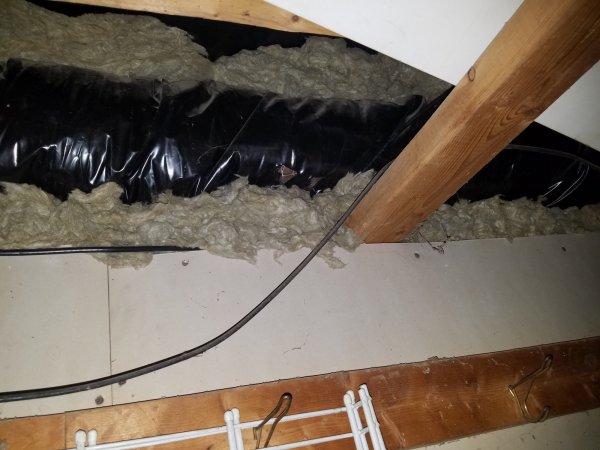

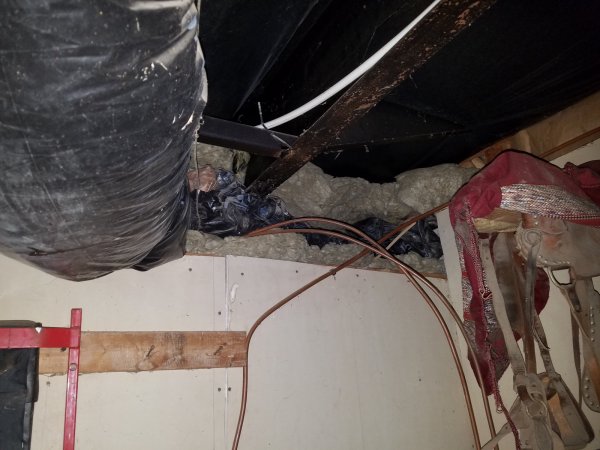

    Just got done stuffing rock wool in the space above the wall that separates the basement from the garage. There were spots where there was nothing there but open air. When my folks built the place they put rolled fiberglass along the top of the wall. It didn't do a great job of filling in corners and along the beams. Hopefully this will show some improvement on sending heat up the steps instead of out the ceiling. I was essentially heating the garage without trying to :picard:

  8. brenndatomu
    25,292
    164,649
    So this is the ceiling of your basement? And it attaches to the garage...like under the garage floor, or??
    Is the house and garage on the same elevation...maybe that would be a better question...not that it matters for sealing up your insulation, just trying to understand what I'm looking at...

  9. Marvin
    Marvin
    Mar 31, 2018
    2,268
    15,302
    Huntingdon, Pa
    The house is a double wide set on a poured foundation/basement. The garage takes up about 1/3 of the basement area. It is not a true walkout basement in the sense that the basement does not walk outside but in to the garage. Then the garage has two roller doors and a side man door. The whole basement/garage is about 6 feet below grade.

  10. yooperdave
    35,877
    225,704
    Understand that when you run the wood stove, it will draw combustion air from the easiest place. After seeing and reading your explanation of the open areas between the basement and the garage, I'm thinking that this was the easiest place for the source of combustion air. So, there was cool air coming in and warm air replacing it (from the garage).
    Stuffing the voids full of insulation should help out noticeably...……..but...….where is the combustion air gonna come from now? Maybe you'll notice a change in the performance of your stove..????

  11. Marvin
    Marvin
    Mar 31, 2018
    2,268
    15,302
    Huntingdon, Pa
    Thank you for pointing this out. I have been thinking about whether this would effect the stoves performance. It does not seem as though it has. My understanding is (could be wrong) that rock wool will only form a thermal barrier. Air will still get through. I'm also sure I did not get the far corners stuffed as tight as I would like because of having to climb all over things in the garage. I am thinking I will try to stuff some in the gaps on the basement side as well to kind of form a 'pocket' above the wall.
    I guess I should say I have noticed a change in stove performance but that is from the wood I brought in Sunday. Apparently it is not as dry as what was stacked higher up in the stack :headbang:
    I tried opening the door to the garage to see if that would help and it makes no difference. I will have to deal with a few junk pieces :picard:
