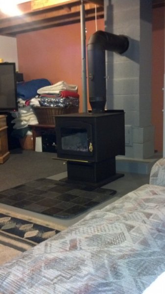

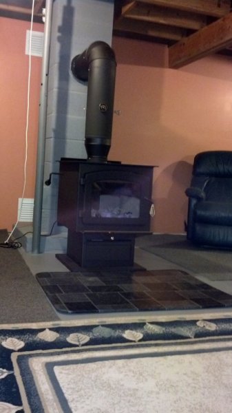

    All I see is bla, bla, bla... Pics we need pics with details or this didn't happen!o_O

    I think the difference will be for me, is it is a one cubic foot bigger stove. That I can load North South which means I can stuff it fuller as no worry about rolling out on me.
    Its is designed for max radiating the heat out of the stove, Which is why its a higher grams emissions of 5.7. Its not keeping the heat in the fire box as well but is radiating more of it out more like an all steel stove. Plus the stainless steel baffle conducts heat up to the top plate better than my old stove that had ceramic insulative baffle board and a layer a ceramic insulation on top of that ceramic baffle board. People wonder why the stove is 5.7 grams emissions, its best of both worlds radiative stove like old steel stoves of the past plus its gets a respectable efficiency and emissions rating. Liike I said above the stove about half way up is all steel. The bottom and 9" of the side walls and back are firebrick. My old stove held its own if the temps stayed 10 deg or higher. If the temps got in single digits for a long period then got minus temps and wind chills it became a struggle this year. I found this onsale for a good deal and I said heck why not why its such a great deal. Plus my old stove is actually under sized for my house. My house is 1900 sq ft upstairs ranch. and the family room down stairs is 27 x 27 feet.
