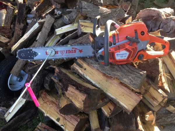

    I was thinking a threaded fixture, kinda like a "door-stopper" with a spring on one side and a wing-nut on the other, to tighten it down. The spring would have an insert at the desired length. A short, stout spring would have some flexibility, and a wood dowel to stick in it would /could be considered a consumable item. I'll have to play with a few ideas.

  4. bogydave
    37,220
    I'm going to try a magnet so I don't have to use he wing nut
    to hold the 17" rod on the bar.
    Still have a stud to go in the 1/4" hole in the bar.
    Ordered 2 earth magnets, 1" diameter circle ,
    Will post when I make the new 17" rod.
    Will be easier on & off.
    Like you idea using a door stop spring.
    The rods I've made are from broken graphite fishing poles.
    Light & tough

    If you have an old computer hard drive laying around you can salvage two very strong magnets from it.
    I prefer a strong spring mounted to a bar nut.

    Hi all, 1st post.. lukem is correct, the neodymium magnets are very strong! There is a firewood measuring tool on ebay that uses one. It looks to be only about the size of a quarter and is rated a 48 lbs pull force. I made one using an old fishing pole and a magnet off a trouble light but its pretty bulky. The results are good though, nice consistent lengths (17") with no pre-measuring.

    Welcome to FHC, GLJ! You found a great site. I tried a trouble light magnet, something went haywire. Figured it would hold, but not so much. So back to the drawing board.
