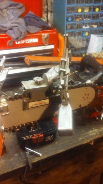

    I have the Granberg file & joint model 12 volt model dremel syle that works well but I still prefer the Granberg File & Joint 106-B hand file. I'll post pic's tomorrow

    Here are pics of the granberg's , I like them because you can set the angle and every tooth is filed the same. I have had the hand file since 1978 it still works well. 20170127_160753.jpg 20170127_160932.jpg
    I touch up my saw after every tank of gas without the guides then do a good sharpening at the end of the day with the file guide.
