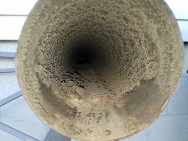

    Yes. It's important to keep them clean! No doubt! I definitely push the limits of my pellet furnace but it self cleans the pot every 10 hours. Going 2 months plus and seeing very little decrease in performance I do tend to go longer than most. But I've ran it for 5 seasons and I am very in-tune with it. I recommend that everyone clean the stove as often as possible (at least weekly till you get a feel) and the venting every ton (until you know how much and how long you can go). I go a full season without cleaning my flue and it's still just a nice light coating in the vertical and about a 1/4" in the bottom of the horizontal (4ft). And even its a nice grey color. No black or soot :)
    But being a NEWB once it's always best to clean and be safe.

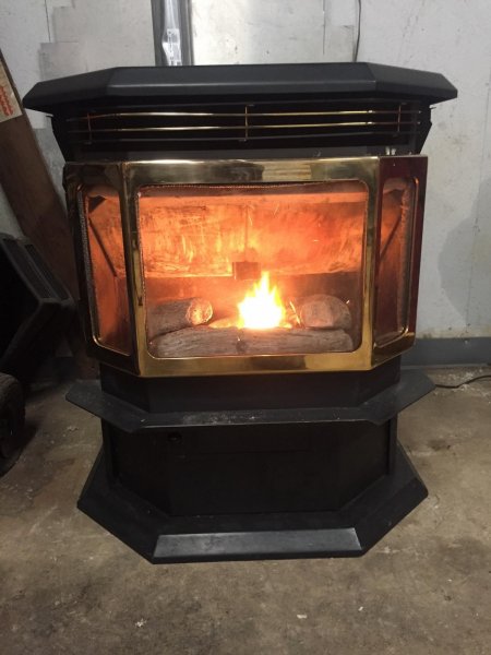

    I just got ECsaws to buy a Quad Classic Bay yesterday! It was on CL for $950 and that's a deal for a stove that retails for over $3,200!!
    Here it is running after he got it home!!
