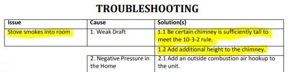

  12. brenndatomu
    25,363
    165,242
    Page 31 of the above manual...

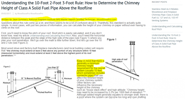

  14. sirbuildalot
    sirbuildalot
    Nov 22, 2019
    3,425
    22,830
    Mass
    I did leave in the caveat "I'm not saying your wrong" :D
    If we look at the pic of her chimney, I see what appear to be four- 3 foot sections of pipe, (top is two pieces, but appears to add to 3 feet) plus the connector pipe which is at least 3' once into the house. The above highlighted manual excerpts say to include or can include chimney connector pipe. That's 15 feet. If the height of the chimney is the problem it would be pretty easy for her to add a 2 or 3' piece of pipe and see if it makes a difference. I doubt it will as its already plenty high above the roof, but who knows.
    What model stove does she have? I'm going to see if her manual calls for a 15' high chimney. Other stove manufacturers installation guides will vary.
    WeldrDave and Screwloose like this.
