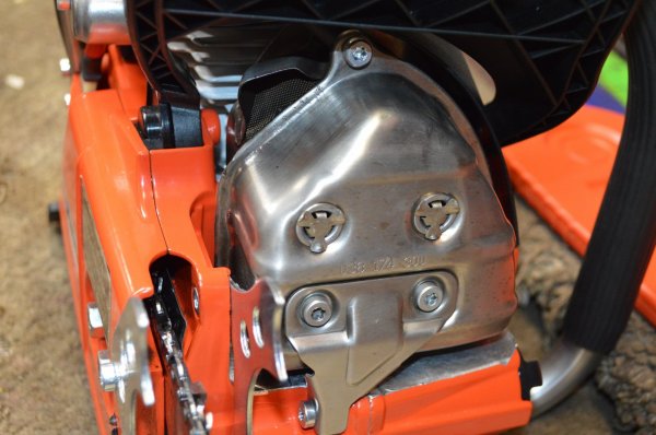

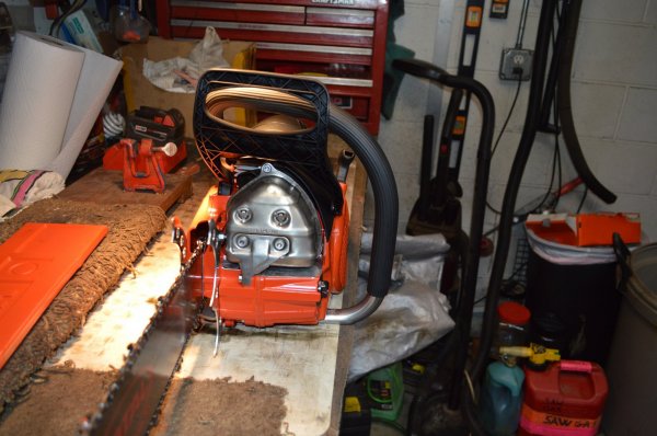

    It went well ! It took about 2 hours . But then I was being cautious not to destroy the muffler ,or crack the crimping . If I did it again , I think it would go fairly quickly . Lost about 6 oz ,there's a lot in there . :) it sounds great without being obnoxious . So , I'm really happy with it .

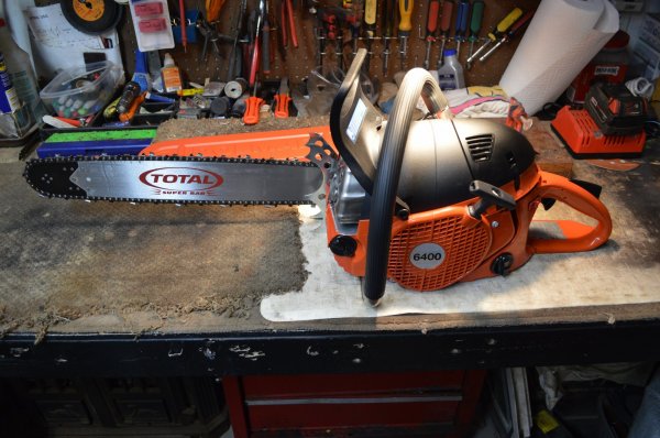

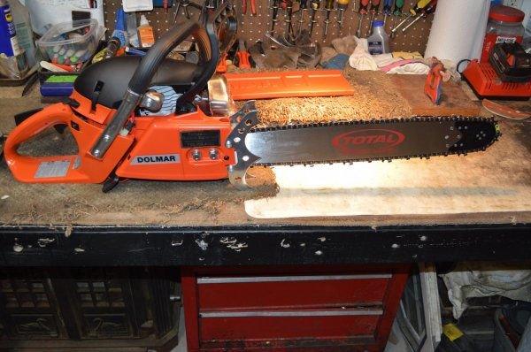

    this is her . DSC_0055.JPG DSC_0056.JPG DSC_0053.JPG DSC_0055.JPG DSC_0056.JPG DSC_0058.JPG DSC_0063.JPG

    Purdy

    2 people makes it go really easy....one to run the torch and one to work the screwdriver bending the crimp back. I did one Tuesday....15 minutes total time on the bench but i dont touch the outlet. Just pull those 2 inner plates and cut the bird cage out.

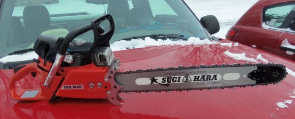

    Well , got the 6400/7910 back from Mastermind . She's a sweetheart ! Only ran two tanks through it ,and only a 20" bar / square ground chain . Need to get a 24" and 8t rim . But I'm really considering going 24" and .404 . The saw still needs some more fuel through it to loosen it up ,but I'm liking it a LOT . The 372 and 460 are likely going to get lonely .

    Is that even legal to put a Japanese bar on a German saw?
