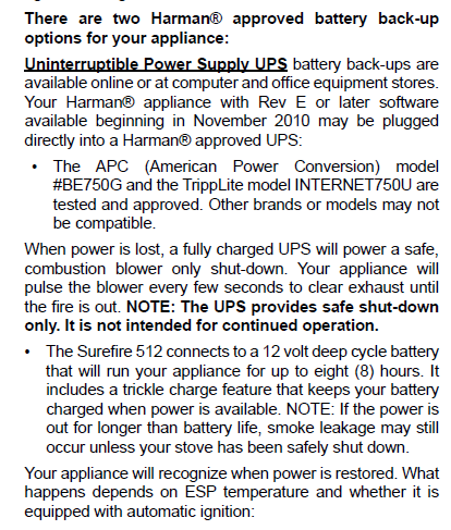

    Funny, I just answered that question somewhere else and took a snip of the relevant part of the Harman manual
