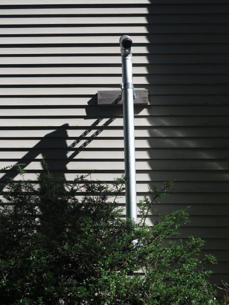

    Welcome to the show VW , you are in the right place , plenty of folks here willing to help with real world experience . I like the out and up IMO it's just better than straight out like others have previously stated pic of mine .
