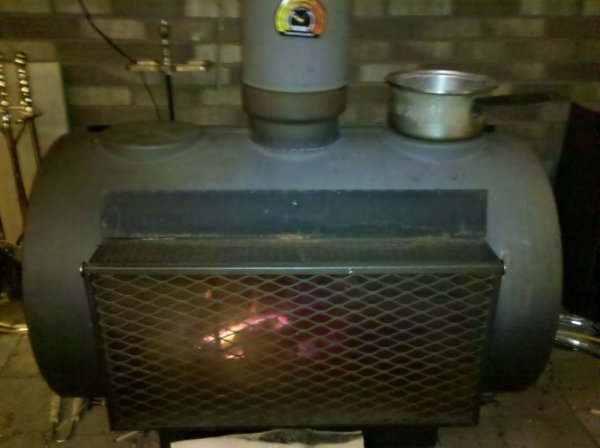

    Put it in last summer, replaced the dragon, the Republic was 3 years old ,came with a 1 year old blower , from CL for $450
    My first EPA stove ,I really like it.
    Gets chilly in the basement but ,Heats my 1200sqft great, Fires start good with the door cracked
    EDIT My old Fire View, was a 8 q ft fire box

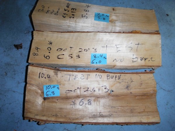

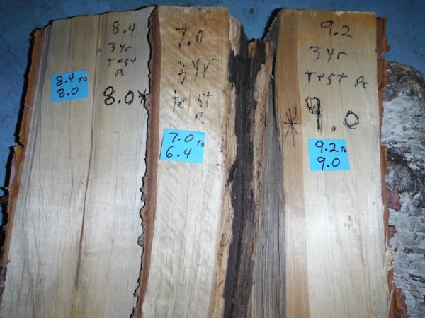

    One year in the basement, along wall by the wood stove .
    blue sticky original weight & now weight.
    3 year wood, was pretty dry it, didn't loose much moisture :
    CSS Oct/2013 wood. (It was in the S&S for over a month before I decide to do the test)
    The 10 pounder lost 3.2 pounds so far.

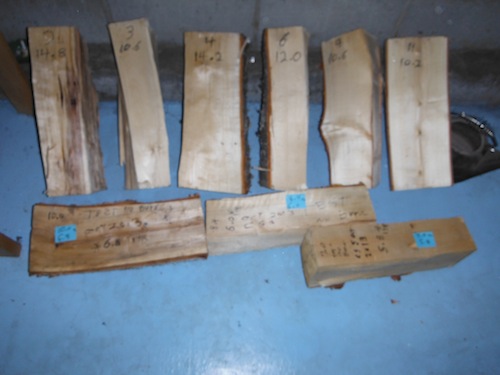

    Will let the 2013 wood there for another year to see what it does.
    2014 splits (today) on the 2014/2015 wood moisture test. (a bit fresher wood weights, should be a better test)
    Shawn Curry, milleo, dylskee and 7 others like this.

    If it is assumed that your 10# piece is now at 20% it would have started at 76.5%.
    6.8/120=.0566, 10/.0566=176.5.
    Figuring that it isn't at 20% yet and that it lost a pound of water in the month before you weighed it makes the starting point close to 100%. That would mean half of its green weight is water.

  18. bogydave
    37,220
    I'm betting that's close.
    Handeling the fresh cut stuff & the dry stuff, next to each other
    what a big really noticeable difference in weight,
    Thing is , I see ice on some of the rounds, on the cut sides in the center,
    some of the water is coming out of the wood overnight after it was cut.
    From the rounds at the base of the tree,
    the water hasn't all drained down , a slower process than I thought.
    Has to go out thru the roots some how ?
