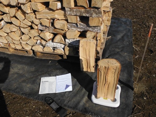

    Some more Data: Calling Winter "OVER" here !
    CSS in Mid Oct, stacked thru mid April (6 months of Alaska winter )
    Birch dries more than I expected outside , thru winter here.
    5 outside green splits lost over 6 lbs of water combined.
    the 3 inside green splits lost more, 7 lbs of water combined
    Outside green splits in the uncovered stack:
    Outside green :
    #1 was 12.6 lbs now 11.4 lbs lost - 1.2 lbs of water (- 9.5% )
    #2 .. 9.6 .. 8.2 .. - 1.4 .. (-14.6 % )
    #3 .. 9.0 .. 7.8 .. - 1.2 .. ( -13.3 % )
    #4 .. 9.2 .. 7.8 .. - 1.4 .. ( - 15.2 % )
    #7 .. 7.4 .. 6.4 .. - 1.0 .. ( - 13.5 % )
    Total
    (51.4 ) .... ( - 6.2) .... (- 12% )
    The inside green splits really getting dry:
    #5 was 10.0 lbs now 7.0 lbs, lost - 3.0 lbs of water ( -30% )
    #6 .. 8.4 .. 5.8 .. -2.6 .. ( -31 % )
    #8 .. 7.0 .. 5.6 .. - 1.4 .. ( - 20% )..
    (25.4) .... ( 7.0 ) .... (- 27.5 %
    The inside 3 years seasoned splits
    was 7.0 now 6.4 lost 0.6 .. ( -8.5% )
    was 8.4 now 7.8 lost 0.6 .. ( - 7.1% )
    was 9.2 now 8.4 lost 0.8 .. ( - 8.6 % )
    So what I called dry still has moisture in it that can be reduced, not a lot but some.
    Shows there is still some room for improving the dryness of 3 year seasoned birch.
    Need one of the math wizards to check my math of % of water lost.
    ( divided weight of water lost by original weight )
    Shawn Curry, milleo, HDRock and 2 others like this.

    Here is some math for you.
    If your 3 yr wood was at 20% when you brought it in you now have wood at 10%. If it was at 17% you now have wood at 7%. If it was 15% it is now 5%. If your inside wood is now completely dry, zero moisture, your original piece was at 8%. I think it is reasonable to assume your 3 yr wood is in the single digits. There still was moisture to be dried out of that wood but you probably are incapable of doing it outside under natural conditions. It took the elevated heat of the pseudo-kiln conditions in your basement adjacent to your stove to achieve it.
    If your outside wood was:
    65% it is now 45%
    60% it is now 41%
    50% it is now 31%
    Clearly not dry as was expected. I wonder how much this was impacted by the unusually warm winter that you had.
    If the inside wood was:
    65% it is now 20%
    60% it is now 15%
    50% it is now 8%
    If my high end guess is as wet as it could have been green that wood is ready to burn today. Now if you could get 2 yrs worth of wood into your basement you could dry a yearly supply the previous winter. However your basement might be pretty damp and dank when you bring in all that wet wood so that might be a bad idea.
