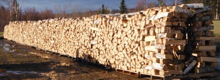

    OK
    The splits in the outside stack
    Frickin cold out there, took 2 trips, that stuff is heavy.
    Then I had to take it back out.

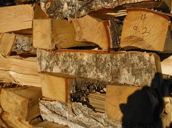

    Found 5
    This is in lbs & the scale is only about .2 lbs accurate
    #1 (a 1/2 round) was 12.6 now 12.0
    #2 (1/2 round) was 9.6 now 9.0
    #3 (triangle ) was 9.0 now 8.6
    #4 (square) was 9.2 now 8.6
    # 7 (square) was 7.4 now 7.0
    So there is some drying in winter, not much though.
    #4 square seems to be the best, on the sunny side , east cross stack end & 3 sides are bare wood
