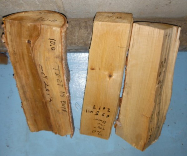

    The 2013 cut splits I brought inside to test.
    4 days later:
    8.4 - triangle split, now 7.8 lbs
    10.0 - 1/2 round, now 9.8 lbs
    7.0 - square - bark 1 side, now 6.6
    Makes sense the ones with more exposed wood surface are loosing moisture faster
    than the 1/2 round.
    I expect it to lose moisture faster then the 3 year stuff I put on the stove now &then.
    Lost .2 so far on both

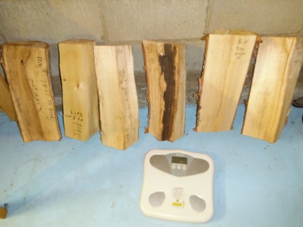

    Some results after 4 weeks.
    the 3 splits cut this year, inside the basement
    10.0 1/2 round, now 8.4, lost 1.6 lbs ( 16% )
    7.0 square , now 6.2, lost .8 lbs (11%)
    8.4 triangle, now 6.8, lost 1.6 lbs ( 19%)
    The 3 splits 3 year CSS. inside the basement
    7.0 sq, now 6.8 lost .2 lbs, (3%)
    8.4 half round , now 8.0 , lost .4 lbs, ( 4.5%)
    9.2 triangle, now 8.8 , lost .4 lbs ((4%)
    The green stuff is losing weight pretty quick being inside.
    The 3 year dry stuff is losing weight, but not much, so far.
    Makes me curious what the outside stuff is doing
    May go dig them out of the stack soon & weigh before it turns cold for the rest of winter.
    They have seen -20° to +39° in the last 4 weeks.

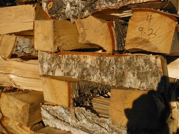

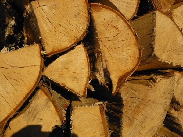

    The outside seasoning stack is showing drying cracks:
    Some drying happens thru winter.
    Goes to show you , get your wood split & stacked off the ground ASAP :)

    Some results after 8 weeks of the inside wood
    Brought inside Dec 12 -2013
    the 3 splits cut this year (2013), inside the basement
    10.0 1/2 round, now 7.4
    7.0 square , now 5.8
    8.4 triangle, now 6.2
    7.0 sq, now 6.6
    8.4 half round , now.7.8
    9.2 triangle, now 8.6
    The 3 year dry stuff is losing weight, but not much, so far. Surprising
    though how much moisture was still in it. House moisture around 35% & stove room near 80° , Dessert like weather.
    Makes me think about bringing in a 2 - 3 cords at a time to add moisture to the house have dryer wood to burn. :)
    Will try to have a MM by spring, so I can get some readings.
