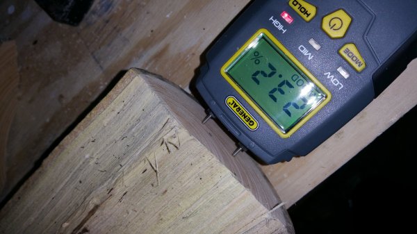

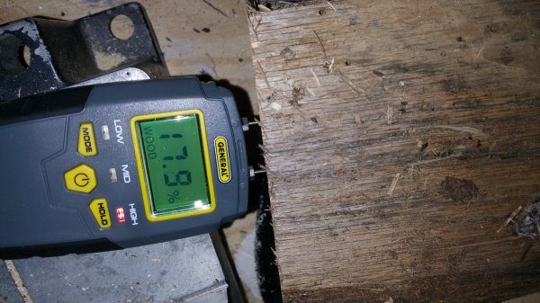

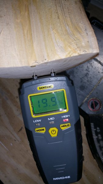

    Yes I'm burning in an open fireplace, not so much for heat, except for the dog and kids who like to sit near it.
    Grabbed the meter. Cut each piece in half then measured on fresh cut.
    First piece(17.9%) was left by previous homeowners.
    Second and Third are from the delivery. Meter has error +/- 2% . And its 10 degrees out but looks like its right in that range of greater than 20%.
    Also measured a piece of the Mulberry that was 32%

    What's the "low" mid and high do on the MM? And, how'd ya get them in so deep? Looks like the points are way in the wood....

    I'm not a MM guy but isn't the two prongs supposed to be in the same grain?

    What'd you cut those with? I think you'd get a more accurate measurement by re-splitting a piece. Friction and heat from a saw can throw off the moisture reading

    That's how I do it, but I've been told it doesn't matter whether you go with or across the grain

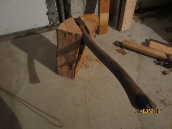

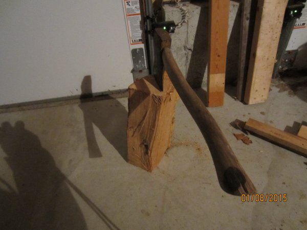

    how is the correct way to measure?

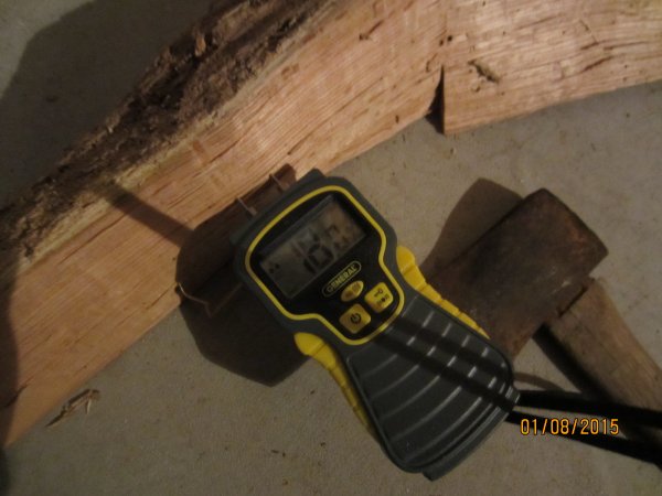

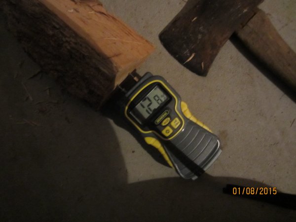

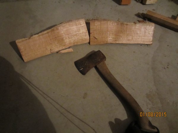

    That's how I do it.
    I usually don't tote the MM around with me nor split a split on the garage floor, but it is #$@%^& cold out and I got that split from the cold outside stack.
    Meter seems to read a couple points higher on a ice cold split.
    I'm not doing a batch test under different heat conditions.
  19. wildwest
    30,800
    145,618
    Thanks! Are your probes touching the wood? Or did you sink them in a bit?
