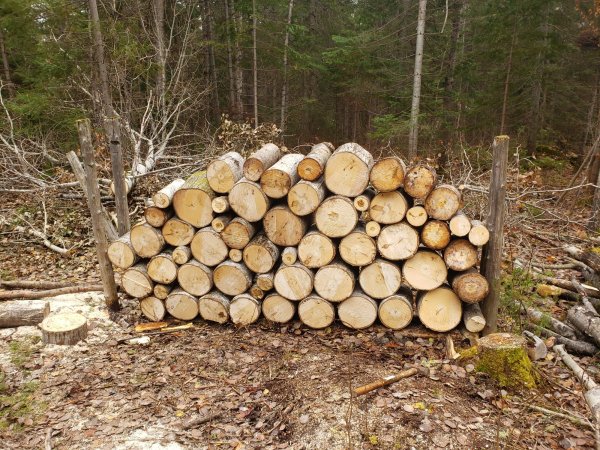

    Hey guys
    I have started cutting my felled trees to length and stacking them on site. I cannot split them on site as i would need a generator for that but i'm cutting them in bar lengths (16 inches right?) so from past experience those do dry somewhat. Not as much as split of course but i will split them next year and season them for another year. The place where i fell trees is obviously surrounded by trees but it is somewhat open and quite windy. I have elevated my stack with small spruce poles so i think i'm doing everything i can for this year. I need ideas for covering the top of my stack for the winter since it's out there in the open, show me some pictures!

    I don't think I would bother covering rounds.

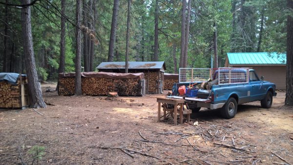

    If you are stacking in single rows, I would suggest 24 or 36 inch wide polyethylene sheet. Apply small patches of duct tape as reinforcement and staple through the duct tape into the rounds. This will leave the sides of the stack open to breathe. If stacking 2 or 3 rows, you'll need wider poly. I stack 3 rows wide and use the woodpile tarps from Northern Tool. Roughneck 3.4-Oz. Heavy-Duty Woodpile Tarp — Brown/Green, 4ft. x 18ft. | Northern Tool + Equipment
    They start leaking after a couple of years, so I put poly sheet on first, then the woodpile tarp for mechanical and uv protection of the poly.

    Looking good. After thinking about this a little more, billb3 may be right. Since the wood is green and bark intact, rain will just run off. There may be no advantage to top covering. As an experiment, top cover some of the stacks and leave the others uncovered. See if there's any difference come spring.

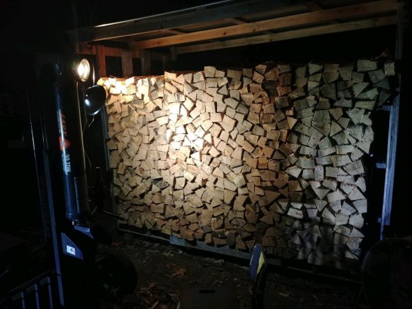

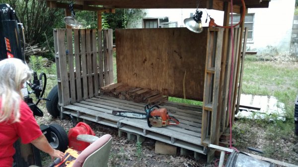

    If you want to build a wood rack/shed with pallets, maybe look at these....
    The back panel comes off, once rack has 2 full rows in it, just helps keep first row straight. IMG_20190625_202511416.jpg

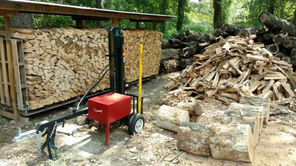

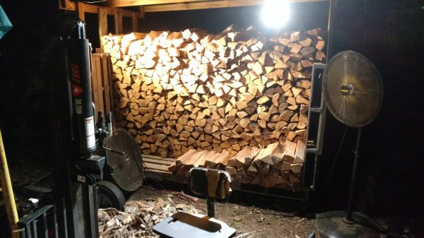

    Is the roof's structure made out of pallets too?

    Making progress and looking good!
    If you are only leaving them for the cold weather than they should be okay like that. Insect and fungal activity is mostly dormant in the cold. Get em split, stacked and covered in early Spring and you should be good to go. Ive left wood in the forest like that. Even split it and left til later.

    Pallet Pete would be Positively Proud
    If you're going to stack in single rows, which I kind of recommend, just use the trees as end posts.

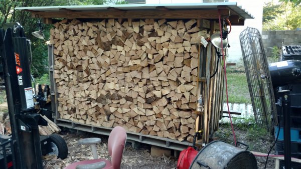

    29,781
    191,329
    No sir, we usually use a couple 2x6x6 on each end as uprights, 3-2x4x10 as rafters and a few 2x4x6 cross pieces to fasten metal roofing panels to. Thought I had a better picture of the roof, maybe you can see what I mean... IMG_20190906_221337056.jpg 9418.jpeg
