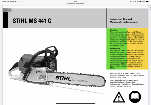

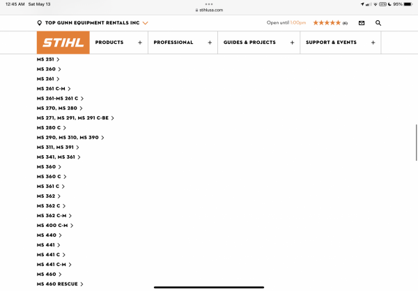

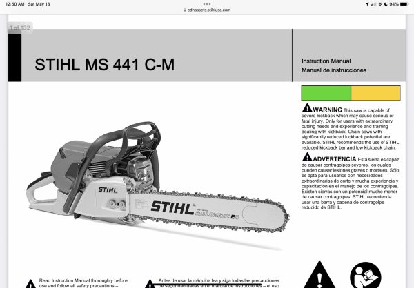

    You are correct. M is for M-tronic. You can go to the Stihl manual website and see the different models. The 261 and 261C are one manual. The 261C-M is a separate manual. Same goes for numerous other saws. Just so happens that currently all Mtronic pro saws are also Comfort saws.
    https://www.stihlusa.com/manuals/
