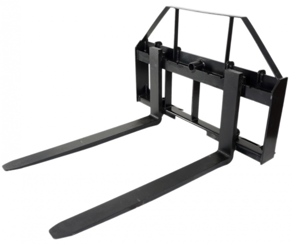

    Backwoods Savage got my forks from Titan
    Can see thru them and free shipping and no tax
    They sell on eBay with free shipping no tax also

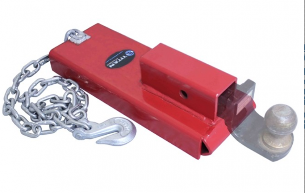

    some people burn a hole in end of fork to install a trailer ball
    Titan had a bolt on ball that works great, So easy to move trailer with it in front of tractor
    Ball for forks
    Forks

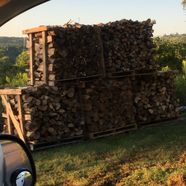

    I understand as wooden pallets are notorious for breaking hard to walk on etc... I am looking into plastic and aluminum one for future cause fuelrod pictureis awesome... would :dex:i I had a source like leoht his setup is brilliant

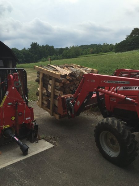

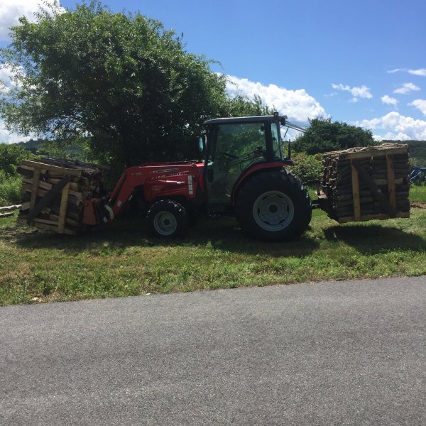

    I'm one of the never say never crowd. Palletizing my cordwood has been the best thing ever. I even made a set for the rear! One thing I will say, make sure your forks stand upright when they're not connected. I bought my QA forks off of CL and they tip back every time which makes it more of a PITA to hook up. When I "park" them I make sure a pallet, or something is on them to keep them upright. I knew this was an issue when I built my rear forks so I made sure they'd stand up. Unfortunately, my lower link mounts were a little too flimsy and broke after 6 months of hard use. I made nice beefy mounts to replace them and wouldn't you know it, it's just enough to make them tip back when they are unhooked! :hair:
    As far as not seeing the front forks, its an issue for sure. Last Christmas my wife bought me a cheap rear view camera and monitor. If I ever get any time I plan to mount the monitor in the cab and run the camera off the loader arm somewhere so I can see my forks. We'll see...
