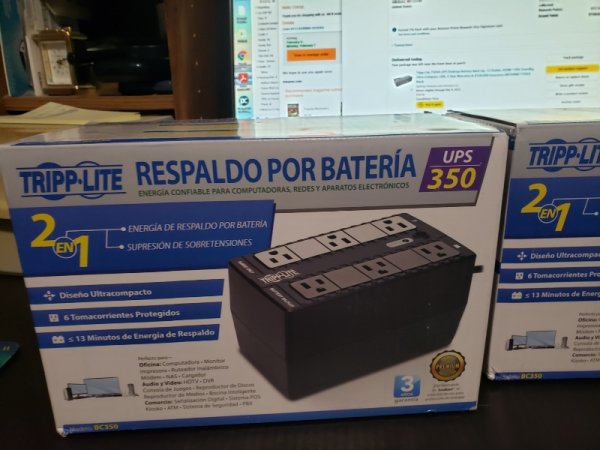

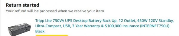

    What I paid for
    What was actually delivered last night - yeah, I immediately got on the computer and filed a return. Between the UPS guy placing a 30 pound box against by storm door so I couldn't get at it without going around the house (I have standing orders at My UPS to place deliveries in front of garage door), and the two below, I was pretty disappointed.

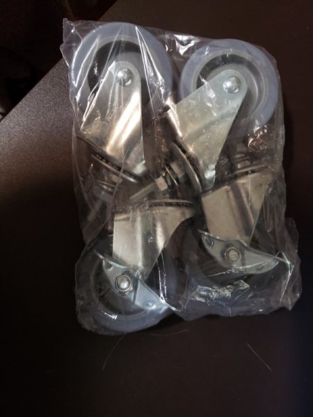

    The delivery combined 3 orders for a total of 4 items (2 UPS, a box of a dozen saline and a bottle of vitamins). Imagine my surprise when a 4th item was in the box - these suckers weigh more than one of the UPS's
    So, it looks like I wasn't the only one destined to be disappointed in my order.
