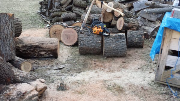

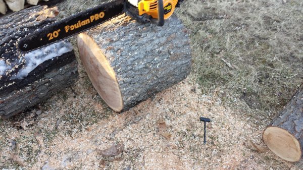

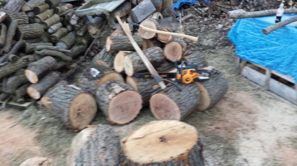

    Ran a tank of gas through the Saw today, cut up a little oak from the pile, I used 32 to 1 mix I had mixed for the weed Wacker.
    I didn't put the tac on it at all but it was running a little lean out of the box, fattened it up and tested it in the wood, saw ran great, heck of a saw for the price:saw:
    Oh Yeah, looked down, there it was, :whistle:scrench laying on the ground, but I put it back in and it stayed there the rest of the time.

  6. HoneyFuzz
    HoneyFuzz
    Jan 20, 2014
    4,490
    14,863
    Northeast , Ohio
    Dude !!! Love the pics ! Glad it's working out. Beautiful day to try it out ;)
    Now I want one lol !

  20. clemsonfor
    clemsonfor
    15,996
    37,478
    Greenwood county SC
    It goes against the saw body, to keep dust out. And kind of a guide
