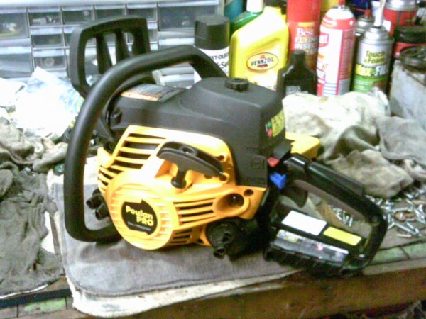

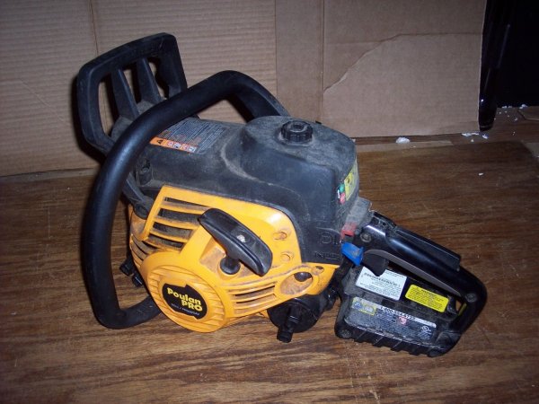

    I grabbed this one one off the bay on the cheap, needed a fuel line which took all but five minutes to install, had it running right after installing it, still have some bugs to work out on it and I'm sure an MM will be in order.....:D..........also wanted to mention that a Homey super EZ bar will also work with just some light grinding on the adjuster pin, I had a few of these bars laying around and will work out great on this saw, a before pic, and an after pic with just a light cleaning, quite sure the saw had seen little use, the sprocket still looked new!........:) s-l1600 (34).jpg IMAG0078.JPG

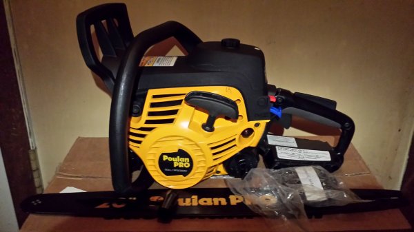

    Here it is, showed up yesterday
  12. dougand3
    dougand3
    Aug 6, 2015
    336
    1,224
    North Alabama
    It may say refurbed, but that looks new. Scrench, too! I'm tempted to buy one...don't need it but that never stopped me before.

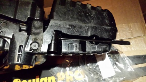

    Scrench goes in here :)
    clemsonfor, Barcroftb and HoneyFuzz like this.
  15. brenndatomu
    25,076
    162,860
    Don't leave it there...mine fell out when I was cutting in a 3' tall hay field, couldn't find it for nothing...the following weekend I dropped the next tree down the fence row and then I used my truck to pull the tree 50' across the hay to bare ground...when I was cleaning up small broken branches...there it was, laying right on top of the flattened hay. Apparently one of the tree branches caught it and brought it to the top! :thumbs:

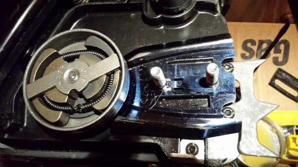

    What's up with this extra metal piece here? , is it supposed to be on here, it doesn't look like it should? it was sitting on top of the plastic shipping spacer.
    Or does it go on top of the bar?
    Edit, okay I put it on top of the bar looks like that's where it goes but, is it needed
    plastic spacer and metal piece taken off
  20. bushpilot
    bushpilot
    Feb 25, 2015
    3,240
    14,366
    Eastern Washington
    Yep, it goes on top of the bar. I think it is a chain guide.
