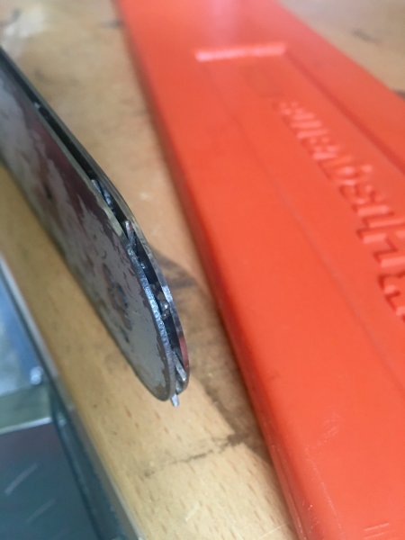

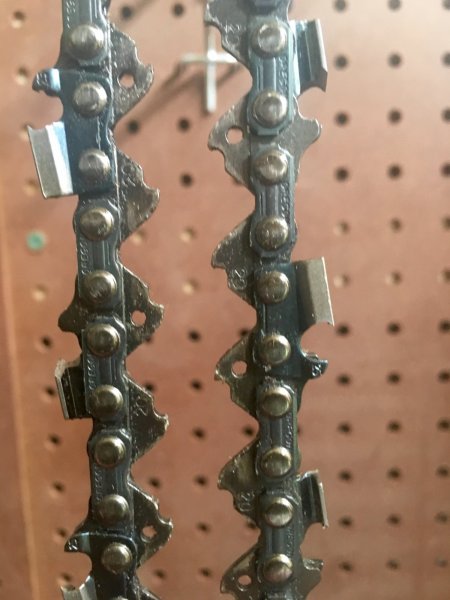

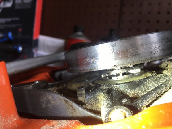

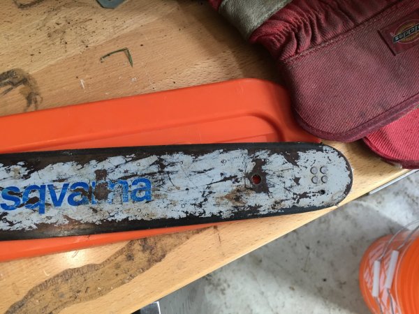

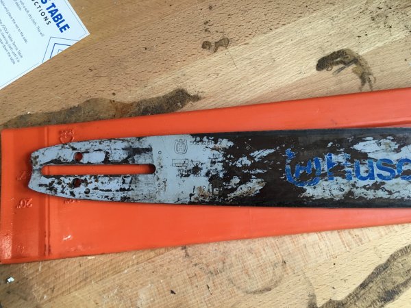

    Ok. An update and some pics
    1) looks like I have a #20 Oregon chain, which is .325 pitch and .050 gauge. That's what it says on my bar
    2) I was able to turn the nose sprocket
    3) Based on the pics...looks like the drive sprocket is ok. At least I can't see any visible damage. However, the bar has a bit of burring near the nos sprocket that I could file down. Finally, the chain drive links have a few spots of burring, or similar damage. Not sure if it's clear from the picture.
    BTW thanks for all the advice and tips already provided.

    if you want to go through the effort either a dremel type tool or a hand file to clean off burrs on drive links. at the nose of your bar is a small hole on both side that is for greasing the nose sprocket. use one of the giant pen like contraptions for that job ( not expensive) i can't tell from the picture how worn the drive sprocket might be. I know my rim sprockets are not all the expensive either.

    I’ll bet it’s your drive sprocket. As it wears, your chain is able to sit deeper in the sprocket than the original groove intended, especially with the added tension created when the chain is running. I had this problem last year. I would tighten my chain, and go to run the saw, and the chain would pop off. Once you feel the chain has the appropriate amount of tension, manually turn the chain with your hand. It may become loose without even turning the saw on. If so, easy repair, and the problem was solved. You’ll have to let us know what you find out.
