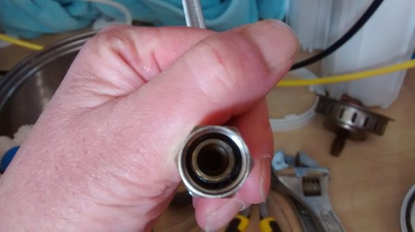

    Plumber said there could be a clog in the line. I turned the valves off under the sink, unhooked the water line after bothering WWW too many times for a bigger crescent wrench (we lost total control of tools since we moved here without a tool bench and so much remodeling, this is your opportunity all you hubbys to groan outloud for WWW that went searching in the freezing cold garage for them). I unhook the R/O filter from the the cold water line=clear. Unhook the hose from R\O to faucet=clear. Plumber said to check the screen, what screen?

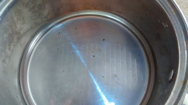

    Just a few black specks after banging the lines around in the cooking pot. (yes, dirty pot from sink if you are wondering, only the black specks are from line)

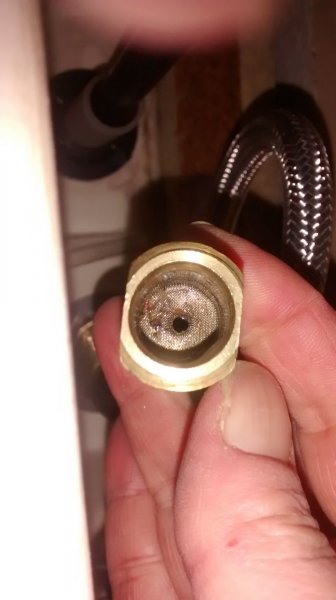

    Bypass R/O, hook up line to cold valve and try again in bucket, yep, runs nice and strong. Only possibilities left are with the faucet itself or the extension hose from faucet. Bothered WWW again to borrow his Petzel headlamp (Stinny ). Found the clog!! Started scraping with a jewelers screwdriver, I could not remove it. Scraped it harder, ooops. Scraped a hole in the screen and figured I might as well even it out and see if there is junk behind the small opening.....Hey atleast the clog is gone:emb:

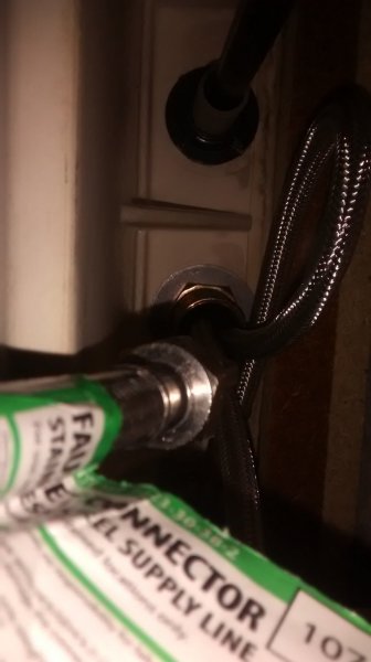

    The hose with the screen is from the faucet, this pic is taken while laying on my back in the cabinet (yikes I will pay for this tomorrow from sore muscles being overused). See the square sides that to hold it still to wrench the hose loose?
    Here is a new shot, still from the bottom of the sink cabinet, I was shooting in the dark but hope this tells you something? This is the SS hose I thought was clogged but was not, that connects to the brass/copper 1/2 square hose that goes to the faucet with the screen.
