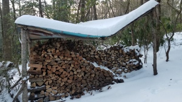

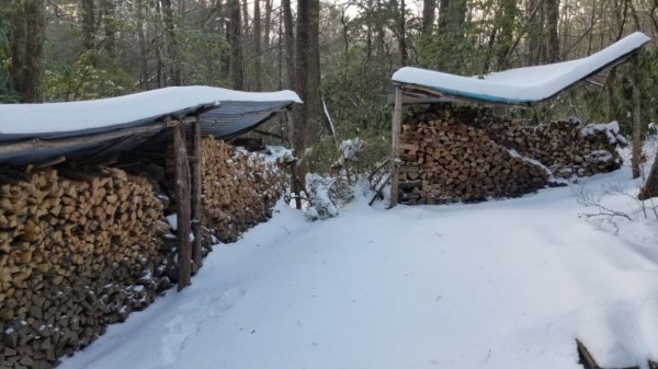

    We received about 10" of snow here in the mountains of West Carolina, and when I went out this afternoon to get more wood I saw this... IMG_20220117_36327.jpg IMG_20220117_8310.jpg
    Not a big deal, I'll just cut another small tree down and replace the beam. But the other three sheds are built the same way and with simmilar materials. The only reason they did not collapse is because they are still fully stacked and the firewood is supporting the roofs.
    So a lesson to us all, watch out for heavy snow loads.
    Stay warm everyone.
    P.S. More precipitation is in the forecast for the rest of the week.

    Sorry about that. Hopefully the snow will melt before you need the wood from the other sheds and you can shore them up without damage.

    I'll get it fixed. I can always build some kind of dead man lift / brace to support it in the short run.
    We might get some rain Wednesday night, just before the temperature drops below freezing, which will add to the weight, and then freeze solid again.
    I hope nobody's roof collapses on their house.

    Yeah, that seemed a little light duty for that amount of span.
    The others are bowing pretty good.
    See if you can shore them up before there's more work to do.

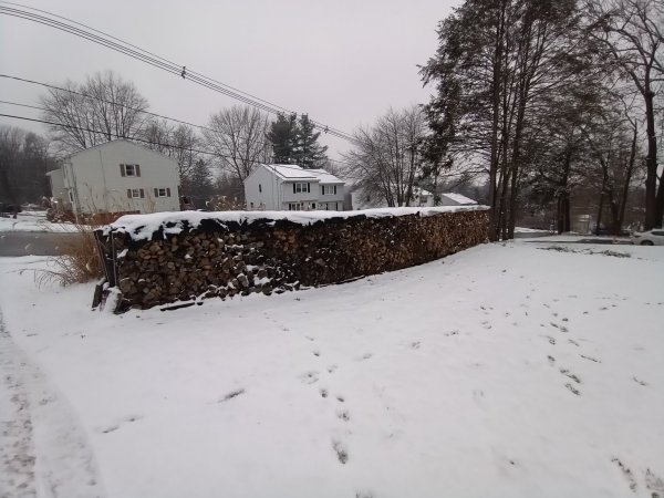

    I havent used solid structures to cover long piles, so far plastic tied down is pretty bomb proof....vs wind rain snow gophers.

    Here in Maine, we always anticipate the snow load will take anything down unless there is a good pitch or supports for any roof. Wet snow will take a roof down for sure. See it happen on a lot of old buildings that are not kept up. Nature always wins.

    I feel for ya on the roof damage. I think I'd shovel those sheds before it rains.

    Grab a rake or something and push the snow off.
