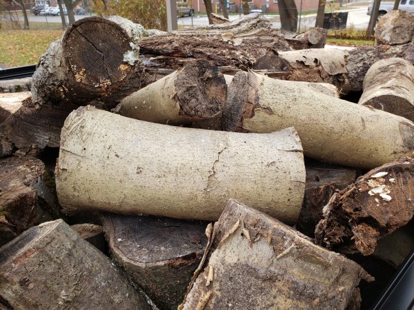

    I looked at the pics on my phone yesterday and thought maple but seein the pics on the 'puter agree with the tree of heaven.

    Thanks everyone really great info as always on FHC. Here is another pic of the other wood I am trying to ID. Sorry not much else to go on was just in the pile and was easy to throw into the truck.

    Also to note on the mysterious wood it had some purple on some of the tips, I assume some type of fungus but never seen it that bright. I'll try and see if I can get a pic of that too. Its all going to get burnt so not a biggie, but just curious. Thanks all!
