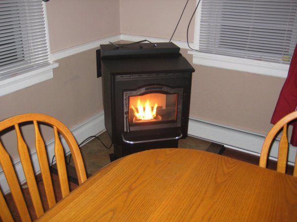

    I can't do that as i have heat shield on both sides of my stove so as to have the stove closer to my walls..so very little radiant heat....
    btw: my probe by the window was long ago when i was exsprimenting on where to put it.
    i now have it taped to the back of the hopper just peaking out above the hopper lid..
    the back of the stove is usually the coolest spot in the house and doesn't get any heat[ corner install anyways] thereby eliminating false [ room is warm] temp reading to the probe.
