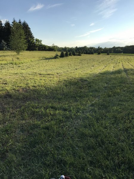

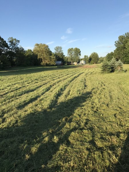

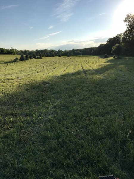

    Ok just finished brush hogging, it's kind of deceiving but my back corner is formed by the stand of 6' pines and it is roughly 4' higher there than in the "low" spot I was talking about. Where I am standing taking the picture is roughly 3' higher than the "low" spot which starts all the way on the left of the picture and is marked by the fence post and travels diagonal toward the other corner. IMG_1292.JPG This looking almost straight back it would be in a rectangular area, somewhat kidney shape with the edge almost running along the shade line and the end on the right just below the apple tree IMG_1294.JPG
    A shot looking back toward the house the end of it here would be down in front of those little pines IMG_1296.JPG All in all I paced it out a bit and looks like it would be in a rectangular area of 90x180 dug out to a kidney shape so under half an acre
