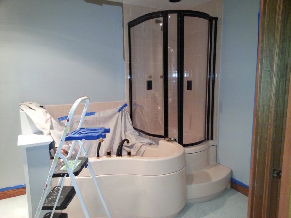

  9. eatonpcat
    10,391
    59,393
    Ok, here goes the first stupid question of the day...I have copper supply lines feeding my Master Bath Fixtures (2nd Floor) and I need to relocate some of the lines...Is there a transition piece I can use to switch from copper to PEX??
    I need to get rid of this monstrosity:
    Horkn and wildwest like this.

  11. eatonpcat
    10,391
    59,393
    Thanks chris , too lazy to search myself!!
