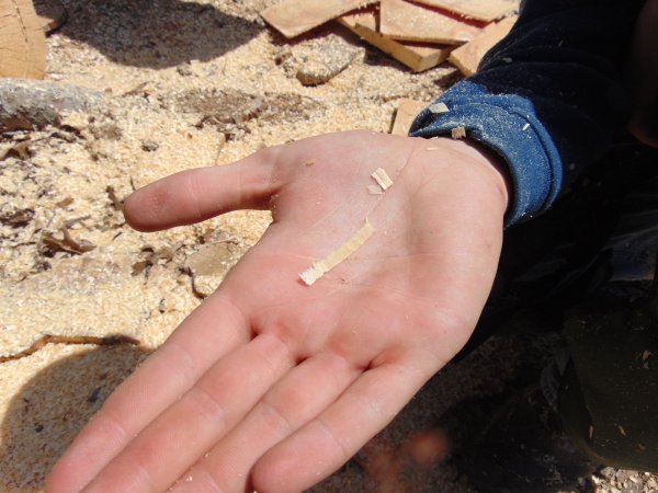

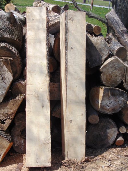

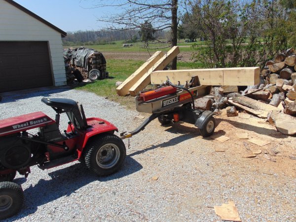

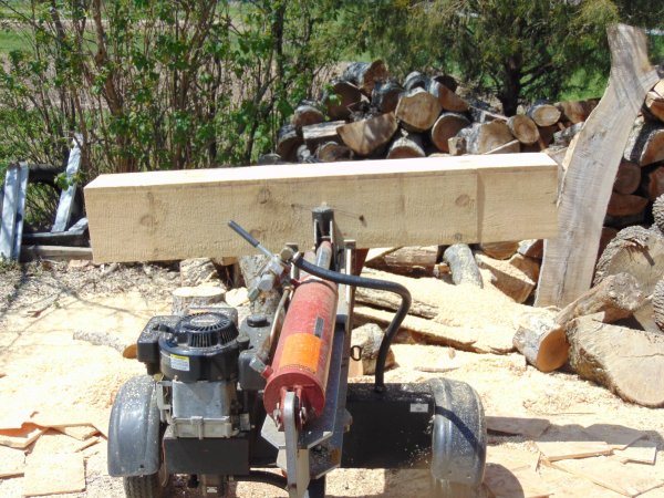

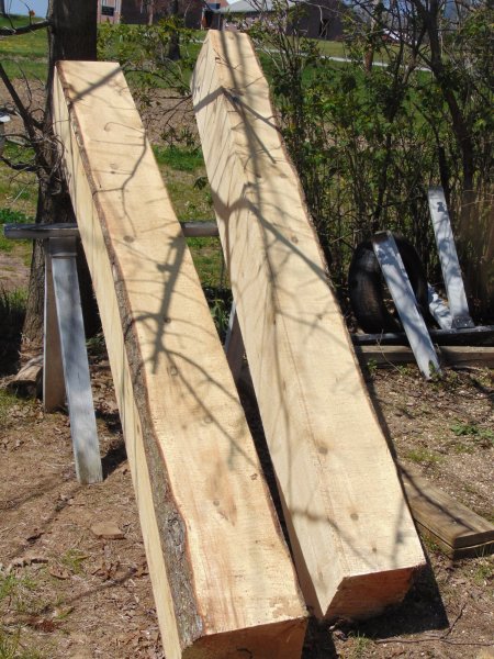

    Finally got my hands on something to practice on! A friend of my dads had 2 pines cut down for fear of them falling on his house. I milled him some boards and he said I could have the rest. Yahtzee!
    The one we cut was about 11 1/4x8".

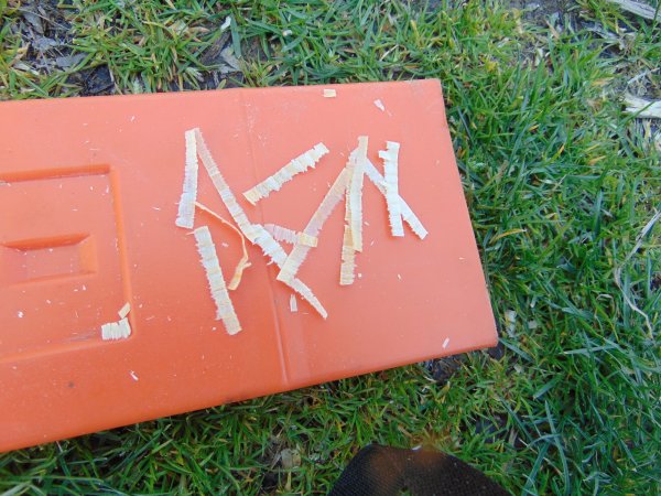

    This was just a square filed "work" chain. Nothing special.

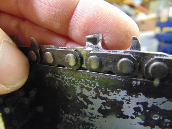

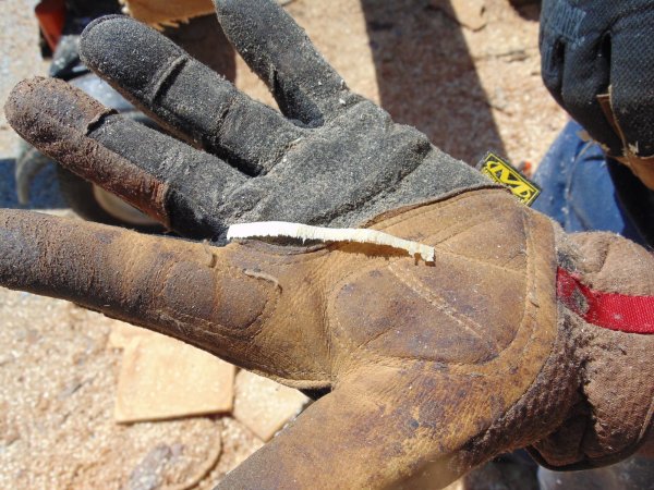

    Then I swapped out to a chain I spent some time on. First cut w/ this chain was laughable. Rakers were untouched, cut was very slow and wandered. So I took 'em down a little and:
    And here's my dd357. Off the roll stihl rs.
    Can't wait to run them w/ the same b/c. Just have to swap to a 7 pin. More on that later ;)
