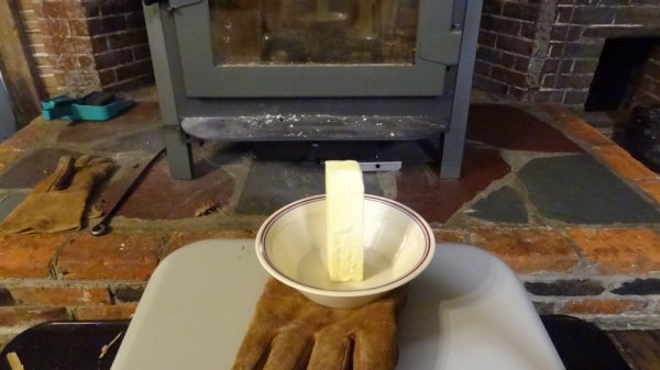

    Cabot Butter, Salted. 38 degree F starting temp, 24" from glass.
    Ideal Steel black firebox,
    Time Stovetop Flue
    00 475 300
    11 475 300
    20 475 290
    25 470 290
    "After" photo. Able to pick up and re-wrap butter; wife will not know if you do not tell...

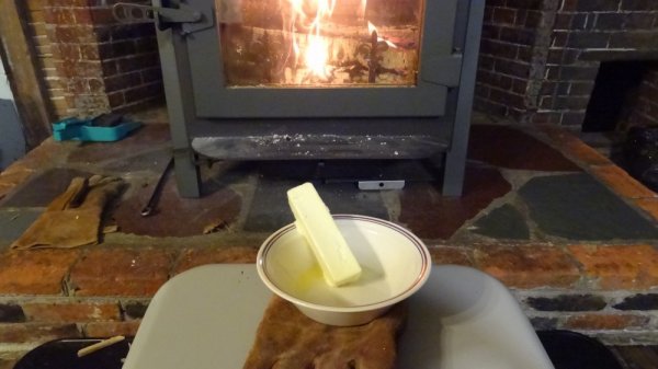

    Different stick of Cabot Butter, Salted, 38 degrees, 24" from glass
    Ideal Steel secondaries in firebox,
    Time Stovetop Flue
    00 550 525
    10 575 500
    15 575 500
    17 Puddles of butter starting to form in bowl
    20 580 500
    25 580 500 Pronounced lean, followed by loss of balance at 25:04. Front half of stick is as soft as, ummm, melted butter.
    I was expecting more dramatic results in my first effort to document the difference between the heat output from the secondaries versus a cat-only burn.
