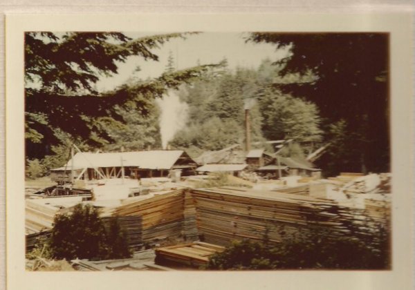

    This is a picture from about 1958 of the sawmill at Telegraph Cove, BC where my father was the steam engineer. When the lumber was cut for our home, there were three differences. Father had long since retired and the steam plant had been replaced by two Gardener Diesels. In the early 70s, my oldest brother was now the mill foremen and he operated the second most modern piece of machinery in the mill - the 1915 planner.

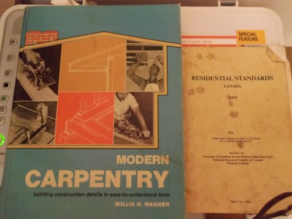

    Now I had no training or real carpentry experience so some research was in order. We acquired two books and these provided the basis for the knowledge to proceed. During the winter shut down we toured several manufacturers of modular homes in the Okanagan Valley of BC.
    The difference between a mobile and a modular unit of that time period. The modular unit was drywall interior finish, was totally wood frame construction meeting CSA standards and with proper inspections, could be placed in most residential subdivisions. The mobile units were built to a much lower standard and were very restricted to where they could be inside of most municipalities.

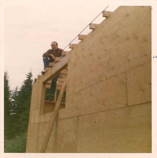

    The start of construction. One of the challenges for this project was the needed inspection and we were outside of any inspection agency's jurisdiction. The town of Nimpkish was only linked to the outside world by 5 hours of logging road. Six hours away we found two inspectors that said they would have been happy to do the inspections but because of the 10 hours of driving they were not really interested. They did not know it but THEY were hooked. I told them that we had a small 4 seat Beechcraft aircraft and that the Steelhead were running in the Nimpkish River just at the end of the local runway. They did not catch any fish but were always excited to know when the next inspection was due!

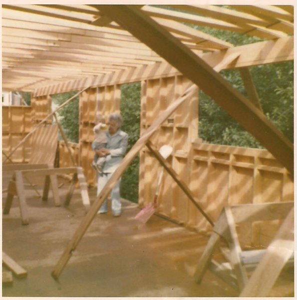

    These are the only two pictures that I have of the construction that are not on slides.
    I mentioned before that my oldest brother was the mill foreman so I got really good lumber. The floor joist and headers are all #1 select old growth Douglas Fir. The lumber for the trusses and exterior walls are #2 and better but my order was all #1.
    The building's two sections were each 12' x 52'. The floor joists run the full 52' length of the building on 16" centers, with full bridging every 12'. To make the long walls stronger, they were constructed as box trusses; double outside trimmer joists and full length headers, with all horizontal plywood joints meeting on firestops. All laminations as well as all gussets on the trusses were not only nailed but a marine fungus resistant glue was used. Ardox spiral nails were used throughout and at lockup, one year was allowed for the green lumber to dry and I have found it is impossible to pull those nails out! Very strong. My father-in-law did the electrical and I pretty well did the rest of it with a lot of excellent advice from woodwidow.

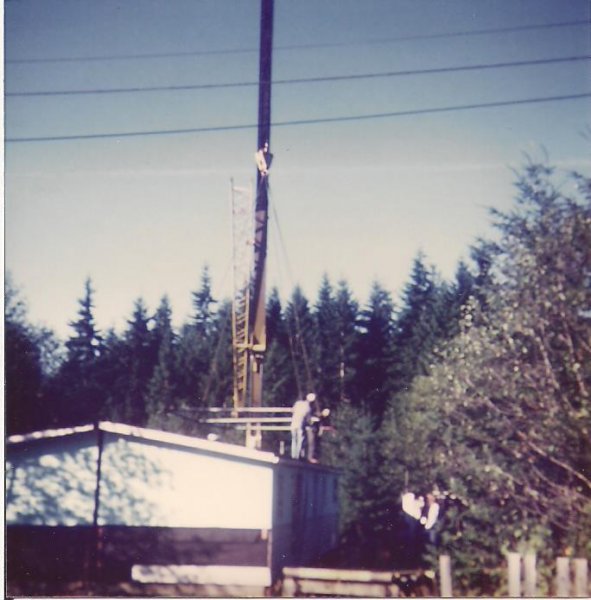

    Pictured above was the start of the move.
    Moving day with lots of help and a really good crane operator and I know a good one when I see one!
    Placing the first half on a float !
