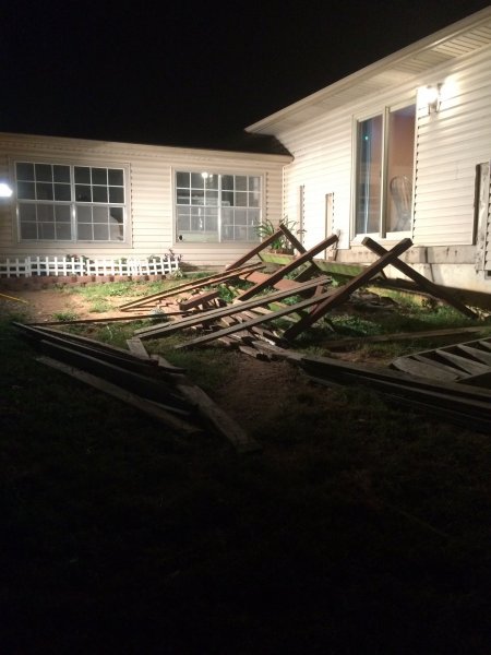

    Tore down the deck now I've got lots of pressure treated 2x's and some 4x's to make a play house for the kids and more sturdy pallet racks to hold more wood! I'm at 3+years CSS and another 1/2 year in 2-6' log form.

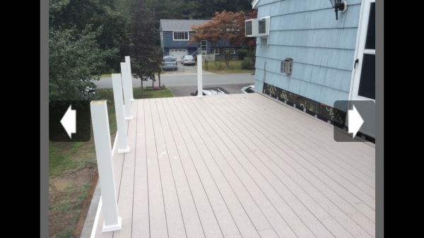

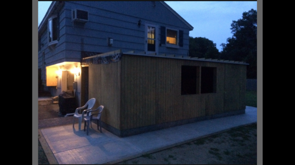

    I replaced my old and rotted 12 x 8' deck with a 12 x 20' deck but when that rotted I replaced it with Azek Decking and Fiberon Rails. But I wanted workshop so I poured a full foundation and then put the Azek deck on the roof!! LOL
    We put in a cement walkway so it would not be a muddy walk to the shed in the spring! I hated that! :)
    We covered the Advantec sheathing on the roof with a layer of Polyglass roofing on top of 2 layers of Bituthene so no leaks!!

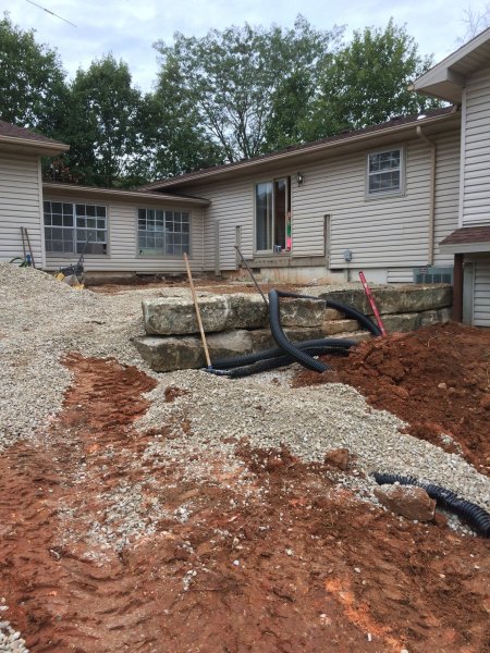

    Went through 40'ish tons of material today. Made good progress, right on track for where I was expecting. Longest and hardest part was laying out the drain lines for gutters and French drains then building up material over them, this was done in 8" lifts. Had to drive over them before getting to 18" was concerned about the weight, put a treated 2x6 and 4x4 down to drive over and spread out the weight, snapped them like tooth picks!
    Another load of rock coming tomorrow if all goes well should have it to grade with fill then 6" gravel pad. May be able to start laying brick on Thursday!

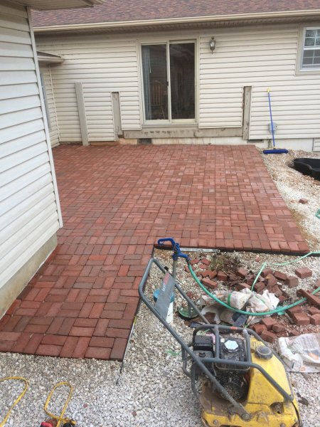

    Finished with 210 tons of material plus what ever top soil I use from my stockpile. Was able lay a 6x20 area with brick, should be able to finish up tomorrow but most likely won't have the landscaping finished until next week.

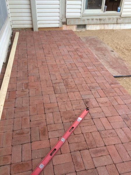

    Still need some more poly sand, I knew better than to believe them when they claimed 75 sq/ft coverage at 1/4" grout lines. I'm at 1/8" and did not get that much coverage!
    You can see the edge of the water garden. Going to lay drip irrigation lines to simplify my watering will do this with the garden next year. Lowes had mums and cone flowers for $2-3 each had to stock up to provide some fall colors. Trying to root some sedum aka stone crop to put in the crevices along with 50-100 hens and chicks (easiest plant to raise ever!) which I poked some in the cracks between the boulders. Don't know what all I'll put around the water garden but I'm thinking xeriscape with a contrast of annuals and perennials on the stone wall its self.
    Was able to grade driveway close to desired slope yeasterday afternoon. This evening I built up the retaining wall another 12" (other side of the drive) will try to do the final grading in next day or two that should allow me to get rid of the small mountain in front of the garage.
    Still need to dig out the left over siding in the barn (and hope it still matches) and fix where the deck was, also I need a set of stairs may do stone treads to match the retaining wall. IMG_1645.JPG
