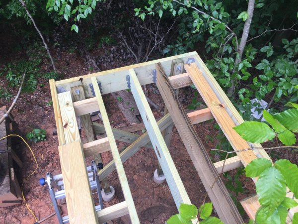

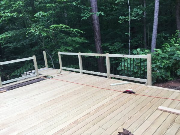

    202CDB7E-972F-4ECC-8617-9D3474AB41AD.jpeg 7C1D62AE-39D8-4E92-8B5A-98A5266EDE62.jpeg So Friday afternoon it stayed dry for a change and sunnny again today until just now a storm blew through.
    GF wanted to bring one of the tables up I’m sure it will be in my way tomorrow.
    Going to order more decking Monday as stupid me figured the long span at 28’ not the extra cantilever 2’ for full 30’ plus the KDAT is 5-1/8” as opposed to normal 2x6 5.5”. All adds up to being short ~10-12 boards

    Camo bottle kozy…..nice.

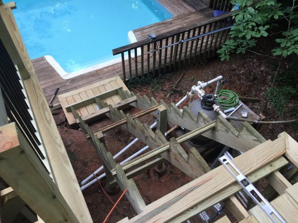

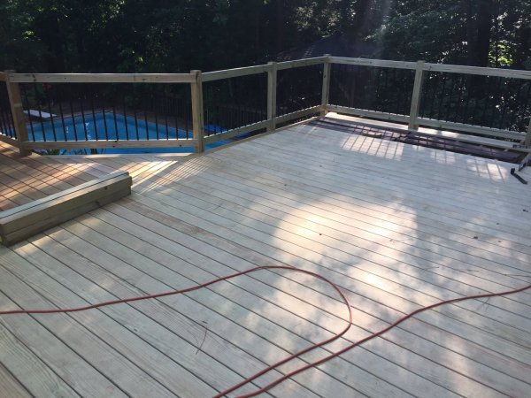

    D90725AB-745E-4AAD-90CE-9412604B7B28.jpeg DACC88D8-52D8-49E0-B9D3-FC842E016FF1.jpeg C8577201-657F-4B57-9574-82A66F0EC4CB.jpeg Doesn’t look like much progress.
    Got the stair landing posts set and finished that framing and bracing. 45 breezeway is done and couple more perimeter boards.
    A sampling of the railing before we are being blessed with more rain....

    Nice looking railings!

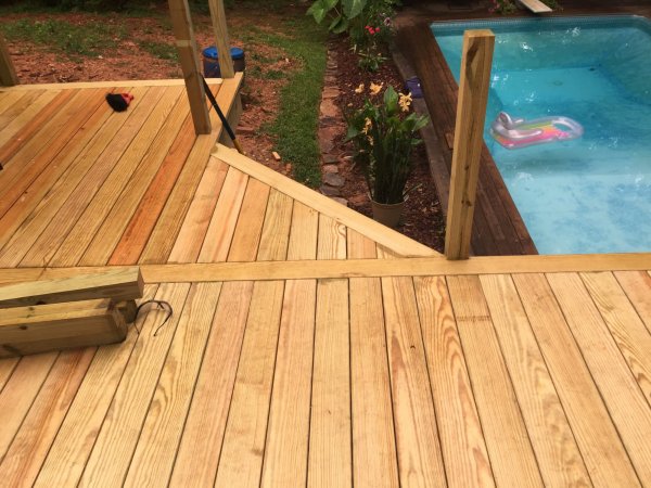

    4B02D3AD-C024-46D9-ACAC-CA8009EEC354.jpeg 2EE0F81B-8C37-40A3-B443-1AEB0419B6D7.jpeg
    Thanks. I like the clean finished look they give and not much off standard wood baluster pricing when you buy bulk. Just need to trim the posts and install rail cap decking when that arrives.
    Note: don’t leave the box of black balusters in the baking sun and attempt to install with bare hands. I was worrying youngsters would be burning their hands, but they don’t absorb heat nearly as bad when vertical;)

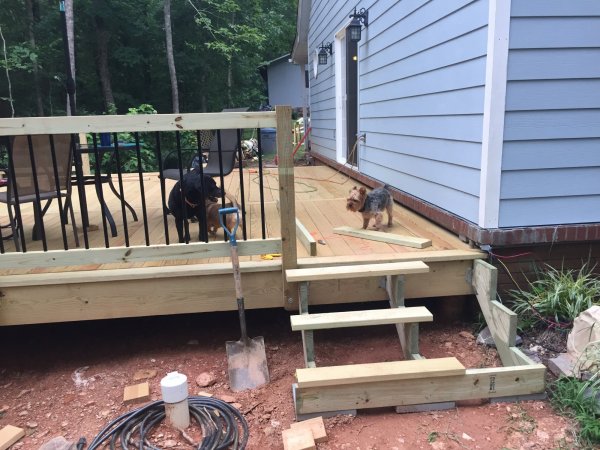

    Got the right side railing and posts in this morning.
    Stair landing built on Wednesday and had the stringers ready to cut before it rained...
    Stringers cut and set Thursday then started on the small box step below before it rained again....
    Finished decking the box step yesterday morning then added mid span 4x4’s to the stairs and since I’m a glutton for punishment poured a few more bags of concrete for those.
    Cut the small stair stingers this morning and set and leveled those on pavers.

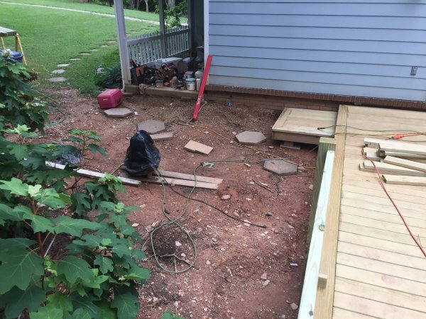

    F3DAC8D2-9D35-4402-A2EB-619CF0747817.jpeg Sorry for limited pic updates this week I’ve gotten 5-6hrs of work in each day before the afternoon monsoons have set in not the normal afternoon pop ups these are training lines of turd floatah storms- getting really frustrated that I’m not done yet.
