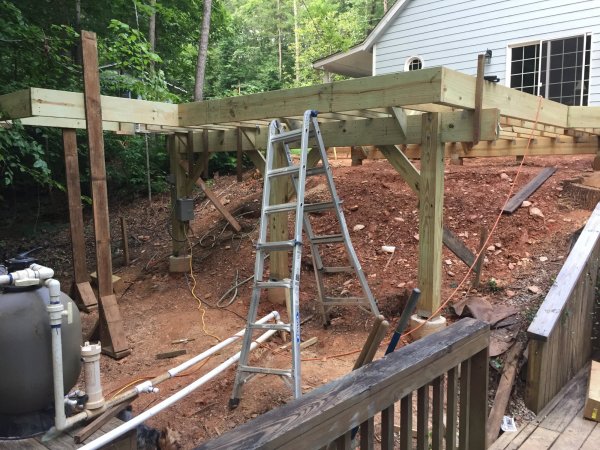

    Did a bunchof blocking and bracing set the perimeter for for stair case landing

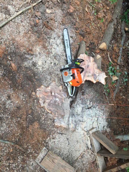

    Dug two more holes for the staircase landing footings. Hole on left took a while as you can see remnants of maple stump in center left
    FHC saw pose maple stump eliminated

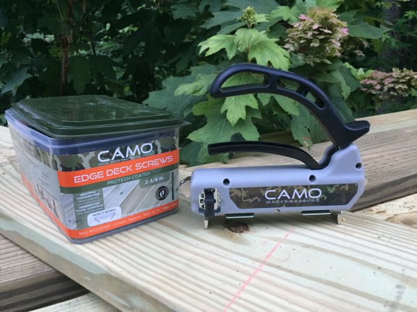

    It’s nice looking decking I’ll show more when I unwrap it
    Camo fasteners and balusters came in Saturday
    Did testing this afternoon. Can only have 3/4” overhang for the screws to catch an outer rim joist and I have to do a little tuning on my picture framing for it to line up right.

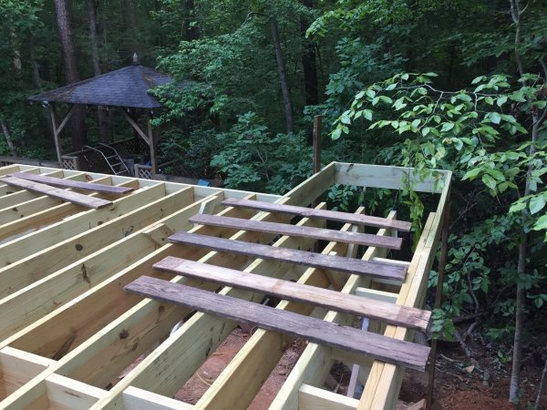

    960F1EDB-A5AF-47D2-A07B-C802075DB188.jpeg Got the stair landing footings poured yesterday afternoon- good times mixing concrete with a 104 heat index.
    Most of the railing posts are set. Used Thrulok connectors- way easier than 1/2” carriage bolts.
    Hopefully some decking starts tomorrow.

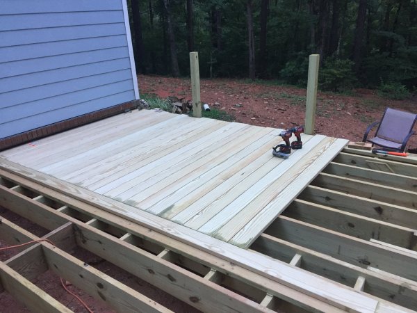

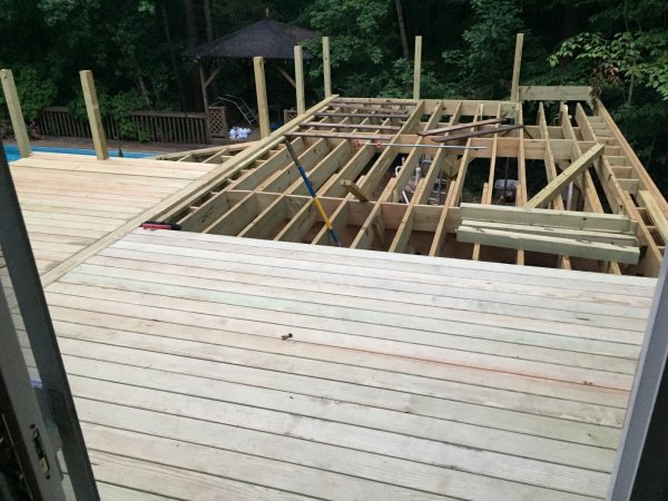

    Weather hasn’t been cooperating thunderstorms Friday and again all morning. Finally broke around 1pm. Got the center picture frame board squared and straight then started running the 8’ section.
    The boards next to house are a bit tricky with no clearance for the drill. Have to start them with the camo jig then finish with a ratchet and t-15 bit

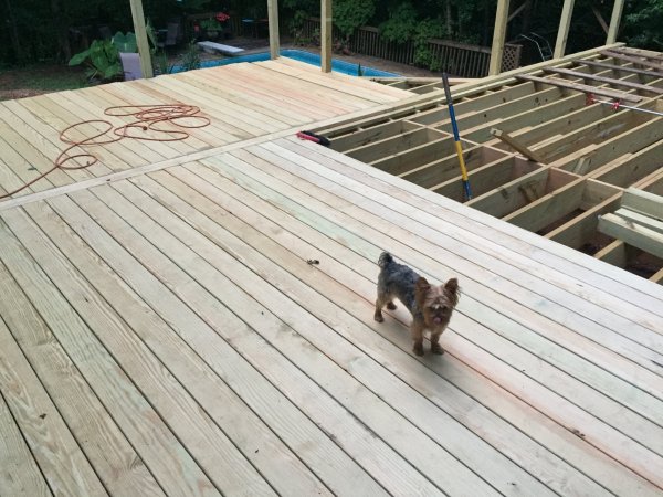

    5739A928-F01E-425C-9C81-1985DEC15706.jpeg CCEB283A-1C18-45A2-BD6D-8ED90CCECF71.jpeg Finished out the 8’ section on Sunday before it was 96 in the dead sun and a handful of boards once the sun moved down past the tree tops.
    Monday afternoon was a washout.
    It was hot this afternoon but got some more laid. The camo fasteners are a bit slower as there is time consumed pulling and spreading boards for gaps but for a fastener free surface I’ll take the trade off.

    Look's like with enough "adult beverages" and a good head start you could make it into the pool from your new deck:rofl: :lol: although it looks like the shallow end.
    Your on the home stretch now, and after all the heavy lifting I bet your ready for some gentle railing work. The icing on the cake.:thumbs:

    Definitely digging the no screw look. What'd that camo-majigger run ya?

  15. savemoney
    I'll like it a whole lot better when the railings are on. I have had too many friends fall off unfinished decks. That is one huge deck. You are going to enjoy it for years to come.

    $38 plus a couple boxes of 1750 count screws @$99 each. They have several different units including a collated feeder
    Camo Marksman Hidden Fastener Tool - DecksDirect

    Thanks for posting the video- I tried yesterday for some reason it didn’t link.
    I actually asked if they carried it at my local Ace as that’s where I get all my lumber and they had no idea what I was talking about.
    They do carry standard Camo brand screws but not the ones for the decking fasteners.
    In between ordering the tool and decking I’ve personally met the owner of My local Ace stores he was impressed with the tool and they are going to start stocking it- pictures of my deck with their KDAT will be in the display.
