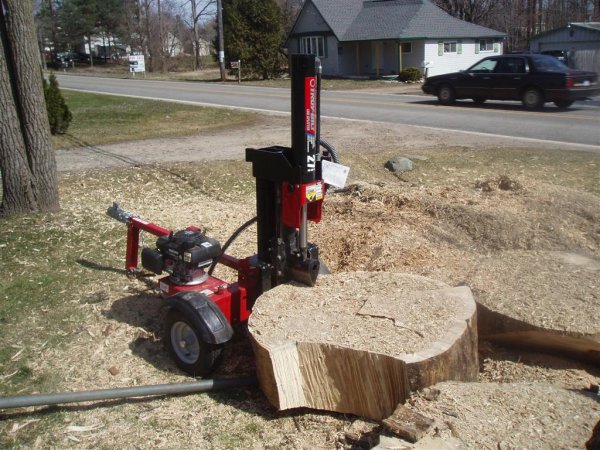

    I like log lifts but there are times where that isn't going to work. No way I was going to get these rounds onto a log lift. P3270008.jpg
    Paul bunion and reelcrzy like this.
  3. Paul bunion
    Paul bunion
    3,397
    13,540
    I see the pipe under there.
