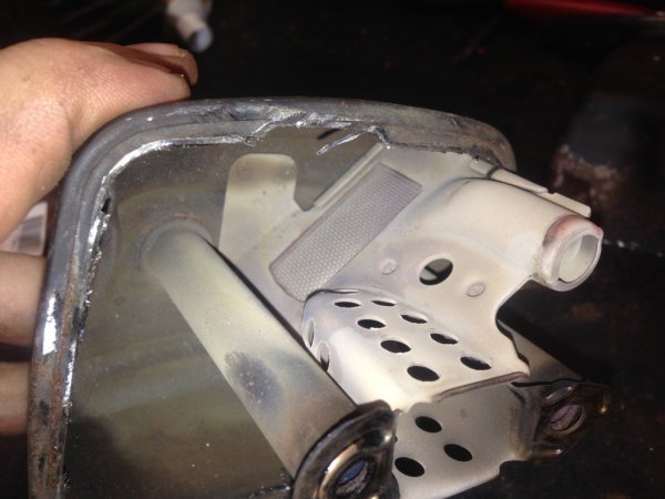

    That's probably the simplest way to do one(it came to me like that). No Dremel was used, a multi-bit step drill was used to drill the holes.
    Make sure you take the muffler off and get any chips out before replacing.
    If you have to buy drill bits for metal the best degree angle for stainless is 135

    Does the mod affect engine life

    IMO if they are too restrictive my guess is they don't breathe properly and hold heat in

    Dont drill it on the saw just to be clear. Metal will get into muffler and be sucked into the saw.

    It's pretty well documented here across a broad range of EPA constrained saws that increasing the exhaust flow path will allow the saw to exhale easier, should reduce back pressure(allowing fresh air&fuel charge from the bottom of the piston into the top) and higher exhaust gas temperatures contained within the muffler can aren't reflecting onto your cylinder and exhaust side of the piston.

    441CM muffler ain't terrible stock. Empty can with no baffles inside. Only restriction is the exit and the screen.

    I'm thinking I will try this soon. It seems to be a drill and a dremel would work ok, and I have both. Need a new drill bit to work on metal as pointed out above.
    Is there a limit to how much of the material could be taken off before it starts to rob performance? I saw above where you want your drilling to remain behind a certain point on the muffler. I will use the examples in the pictures as reference of what to do.

    You dont need to paint it. It will carbon up anyway. It will rust if it gets wet eventually anyway.
    You want to keep you hole behind the deflector to force the exhaust forward and not burn plastic but you really can put a hole anywhere , just be conscious if it will be in your face or where your breathing or dont want to burn plastic parts.
