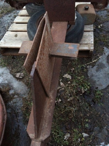

    Here we go Eric. Pretty straight forward I had the side plates bent a few inches back from the front, welded them together and then put on a piece of tool steel for the front cutting edge. The wings are made from old snow plow cutting edge with the knife just flame cut and ground. image.jpg image.jpg image.jpg

    Sam,
    Nice! So you have a flat plate style ram pushing into a fixed maul head... My H/V splitter is the opposite of this. Any suggestions as to fitting a cust made 4 way on the moving maul head? Little dark now for me to be taking a picture for reference, but tomoro perhaps?

    I've contemplated this myself Eric. My other splitter is the same type that you have and I would really like to have the 4-way on it. I'd like to rebuild my pusher wedge into some sort of changeable style possibly using a receiver tube or similar method. Then I'd build a single, 4-way,maybe a 6-way, and a tire bead breaker...eventually!

    Well Sam you've already proven its good for other tasks (pressing bearings) so bead breaker seems in line with your ability to multi-purpose!
    I too like the idea of a six way splitter, but as for the pusher wedge adaptation, I've even thought of my pusher wedge being converted to your plate style, and plasma cutting the foot off where the multi wedge would be placed... Make sense?

    Makes sense to me and I've thought about that too but for my purposes I like the wedge moving. Eventually this splitter will be remade into a table style vertical model and that's not conducive to a stationary wedge.

    have you checked out the four way they make for the husky splitter, might work on yours
    SpeeCo Slip-On 4-Way Wedge for Huskee® 22-28 Ton Log Splitters
    • 6 in. W x 9-1/2 in. L x 7 in. H
    • For 22, 25, 27 & 28 Ton Log Splitters with 7 in. wedge
