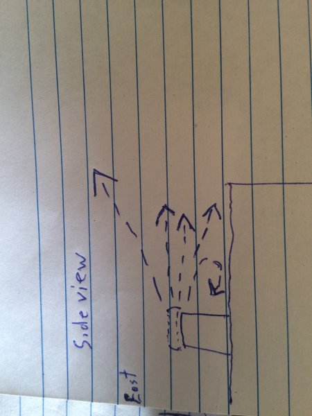

    Here's my artists rendition of smoke flow out of the chimney. Funny thing is, the 5 arrows indicate how the smoke flows out, but it would flare out to the sides at the same time ( a view from above would show it zipping left and right) all while the smoke was changing levels. This happens constantly. No wonder I had too much draft, not enough draft, and variable draft, all in the same 10 seconds. Forgot to rotate the pic to the right, but you get the idea. image.jpg

    I have one of these in stainless....never put it on yet...

    If I had problems from more than one direction I'd consider one of those for sure. As a general rule here, any other wind is either neutral until about 20 mph, or slight turbo charge , except for winds from the south, they turbo charge my draft even at 10 mph. The damper takes care of this easily.
