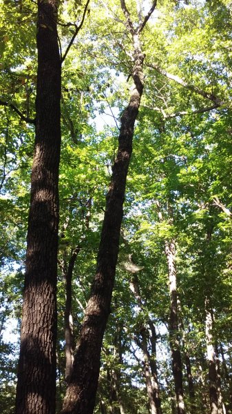

    There is a fairly large dead chestnut oak on the property with a fair amount of lean to it. Barely any branches left, just a few larger ones; which I hope give way and not hang up in a nearby tree. I would like to drop it for the wood. My question is that do I have to worry about barber chairing on this tree? If so, how do I minimise that risk?

    Let me go take a photo to share.

    From what I know, if the trunk is thick enough, aftervthevface cut, use a plunge cut to establish the hinge, then the back cut.

    A bore cut will also tell you if it is hollow. You can smack the tree with an ax or sledge hammer to see if it is hollow as well. A bore, or plunge cut will probably tell you better then beating it with a hammer.

    Be very careful. That's a pretty substantial lean.

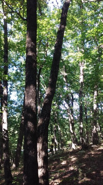

    If you look in the second photo; my concern is possible hung up in that tree behind it.
