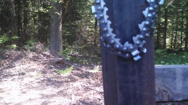

  8. papadave
    Found the box the 18" chain came in......it's Oregon 95VP072G on a matching Arbor Pro bar. I'll have to get the number off the cover for that, or take a pic.
    Also, I hung the 2 20" chains on a hook and didn't pay any attention at the time, but it looks like the chain I had done at the hardware is slightly long than the original Husky.
    I counted 72 DL on both of those. I'm going to go double check. Again.
    Dave, I'd love a new 562 xp or similar, but it'll be a couple years.:)

  13. papadave
    I shall rename thee.....Auto incorrect.
  14. papadave
    Pulled out both of the 20" chains.
    The newer Oregon is about 1/4" longer.
    Pallet Pete and Stinny like this.
  15. MasterMech
    9,648
    26,044
    Greenville County SC
    If the pitch and link count is the same, than it has to be some kind of manufacturing variable. How did you shrink the old one? :rofl: :lol:
  16. papadave
    I have a genie in a bottle...with 2 more wishes.
    Now, I'm thinking I might have made a poor choice in having that chain shrunk. Dang it.
    With the longer chain, I run out of adjustment to get it fully tightened. I counted the DLs and they're both 72.
    Weird.

  17. clemsonfor
    clemsonfor
    15,996
    37,478
    Greenwood county SC
    3/8 chain is 72dl in 20" .325 chain in 18" is also 72dl. Chain gauge is like the length of 3 links or pins or something...anyway .325 chain has smaller links making it have more per inch and it just happens the dl counts on those sizes are equal.

  19. MasterMech
    9,648
    26,044
    Pitch is the distance between any 3 rivets divided by 2.
  20. MasterMech
    9,648
    26,044
    Have a link knocked out of the long one.
